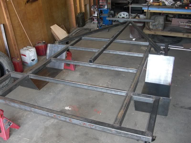

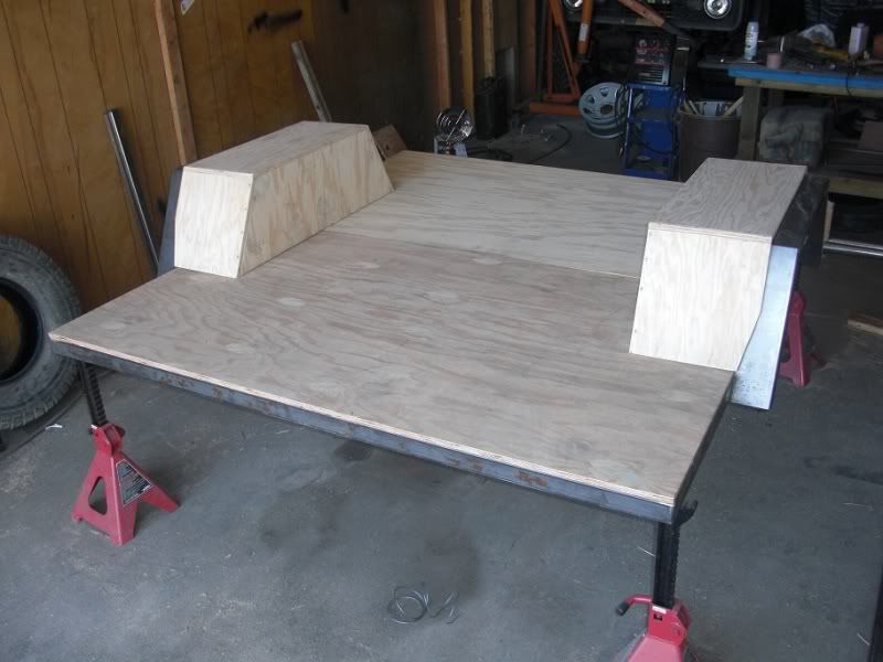

Here's a couple of pics from the weekend, not much changed, just fine tuning the bed supports and planning out the rear stabilizer setup - going to go with a set-up similar to the one AT sells but permanently mounted to the rear frame of the trailer. Kid showed up for the summer and relatives have been visiting...progress has been slow

That's really coming together..is it lighter or heavier than it's original configuration? Plan on painting the fiberglass top and the trailer body to match the truck?
Looks almost like there's enough room for a water tank behind the tongue box.

Definitely heavier, from the box down at least. The top is ABS and I plan on building an aluminum top this Winter if I can keep the weight down (might go with something like Nidacore instead). The paint color will stay the neutral grey (lighter shade top) because it is going to be pulled by one of three different color rigs. The space behind the tongue box was sized for two plastic cargo boxes, a propane tank and two scepter cans for grey water. The water tank will end up behind the axle to keep tongue weight down. I thought of the drop foot style jack but the design I'm building will stabilize out to the side more, since it is getting so tall. I already have a receiver tube welded in the center of the rear of the frame for the slide in step.
