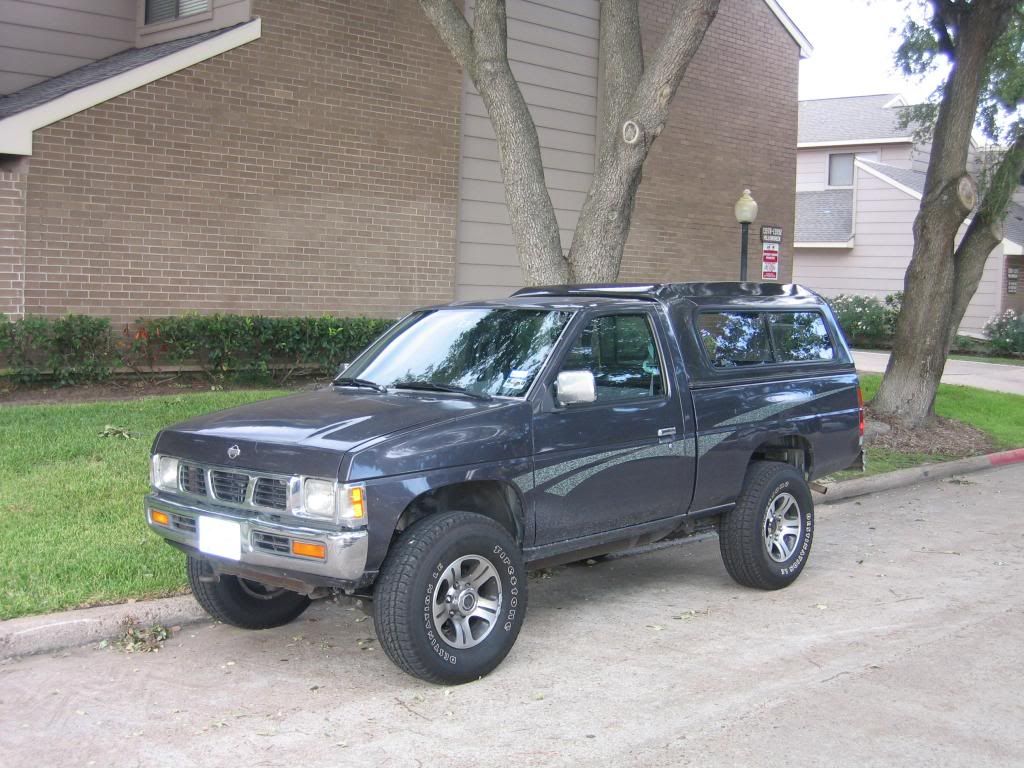

Strizzo
i had a 96 hardbody for a short time that had the torsion bars cranked and i think an AAL kit on it. it looked good, but they ride kinda harsh that way.
this was it, never really did much with it, sold it when i realized it wasn't going to do what i wanted to do with it (wasn't comfortable for long trips):
