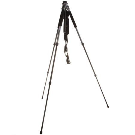

http://www.adorama.com/BG055CXPRO3.html
This has got to be one of my faves. One of the things I have been told although I have not tested is that with the screw type leg locks like the giotos have a tendancy to wear faster due to dust
Supposedly the Manfrotto locks are a lot better.
