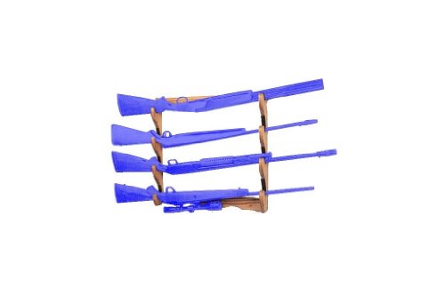

It really doesn't matter which orientation you carry them in. The main issues for me would be A) keeping them protected from damage, B) Keeping them from prying eyes should you be parked in a populated area, and C) Should those prying eyes decide to break into your vehicle, keeping them from being stolen.
Now of course if you are going to be in the middle of nowhere (like much of Wyoming) B & C are probably less important, but I would still factor those into your plans.
If you decide to set them up on their buttstocks, the cabinet might look more like a gun cabinet than just random storage. For this reason I would choose to lay them down. Long guns are typically most stable upside down like this picture:
I have seen some pretty cool under-seat gun cabinets that hid the guns well, protected them, and did not take up precious space.

my biggest worrie is supporting them while in motion on rough roads and situations. I carried in the back window for years up side down straped to a gun rack. This is however not sucure and verry hard to hide from prying eyes. upside down may be hard laying down to support them
ExpoScout
Some wood with some U-cuts lined with felt is a good way to go. If you make them narrow enough they will cradle the stock and the barrel and won't allow them to rock back and forth too much.
