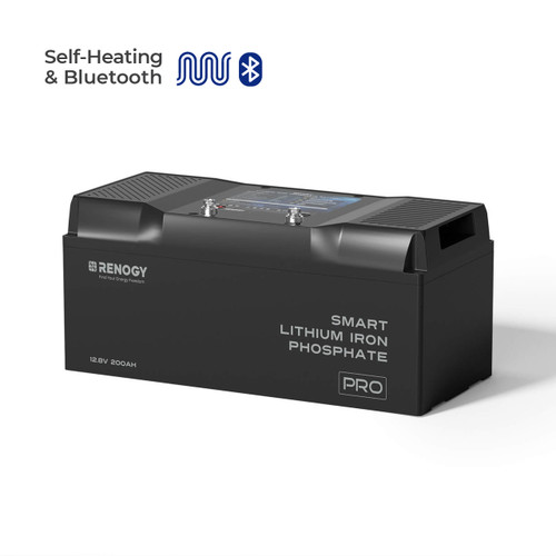

I would be curious about what gear folks would recommend as the best for the later option. I think I'd like to buy a couple of these Renogy 170 amp/hr LiFePO4 batteries if I were building a new system from scratch:

Renogy 170 amp/hr LiFePO4 (Dimensions: 13.88" L x 6.32" W x 10.92" H)
