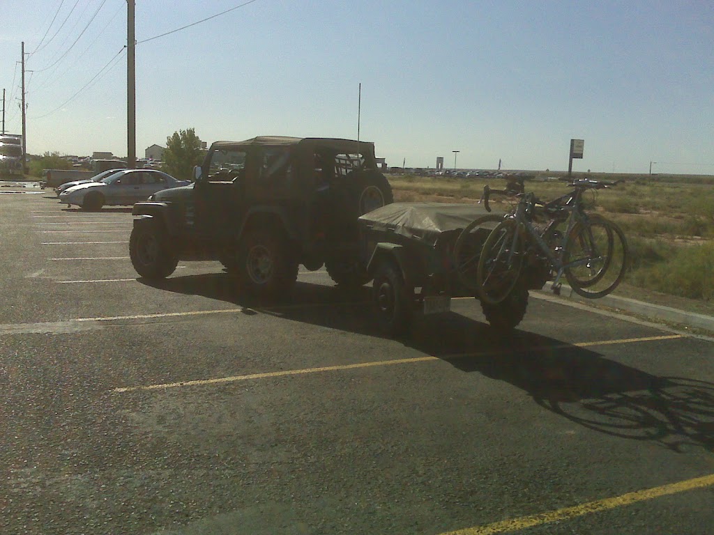

I noticed virtually no difference in handling, bouncing, weight, or anything, with a 2-station bike rack mounted to my trailer recently:
Bigger heavier tow vehicle :) I was also using my 3 bike rack that fits the TJ with the 35 on the back, so it sticks out a little further. I picked up a 2 bike rack now for the WRX (comes a a 1 1/4 and 2" adapter) It worked a lot better.
That was on my trip out here. Without the bikes it was just barely balanced and I think that put it over the edge. The trailer is now back to behaving after swapping the pintle mounts so the nose points down a little better now.
To the OP: That picture is probably about 3000 miles into a 3200 mile trip across country. As you can see everything is still ok. I'll even be riding that cannondale home today.
