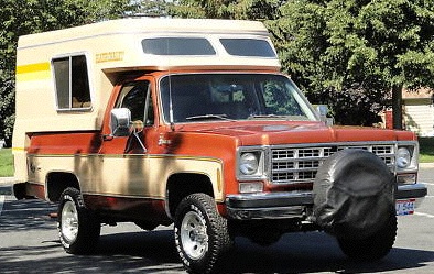

It's serial #0983, pic below, owned by one of the guys in our Yahoo chalet owners' forum. He bought a different one, so two's a crowd for him. Tough economic times have put so many of these on the market (50+ at the moment), I thought it would be too much for me to be piling these into various Expo posts, like I used to.
For folks who want to keep an eye on what's available, check into my regularly updated Google map of where they are for sale. Same old full disclosure note, I don't get a dime for doing this, just want 'em all to go to a good home instead of being junked or split apart. PM me for specific contact info.
