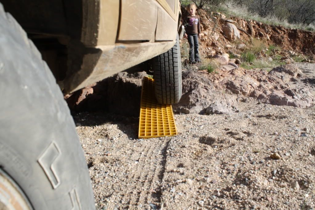

One of my freinds made these for me.
Last year on a trip with my Dad it would hav e been great to have these.
I plan on mounting them on the rack I am going to install.
I tried out both the ten inch and twelve inch. Both seem to perform the same.

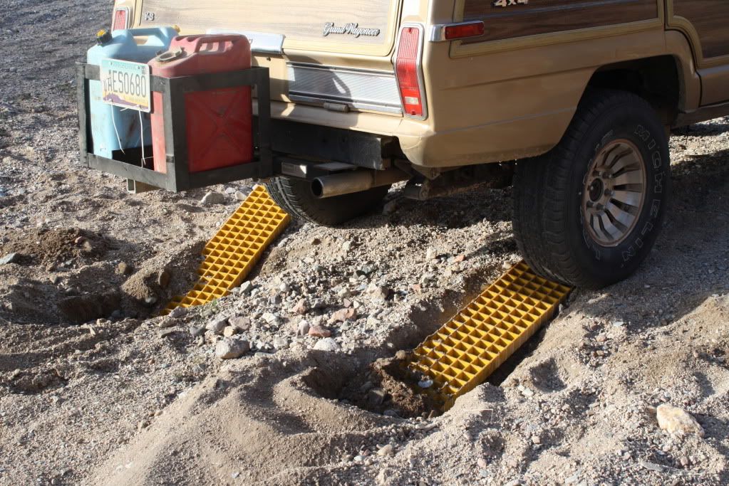

Thoroughly tested in the desert !
get stuck, reverse 2 ft insert boards into the trench drive off and repeat untill back on terra firma.
in sand they dig down, add a small length of rope and handle for retrieval
do not try the tie to the vehicle trick,,,you will either come to a halt or they will hit the back of your truck !
yes mind the splinters !

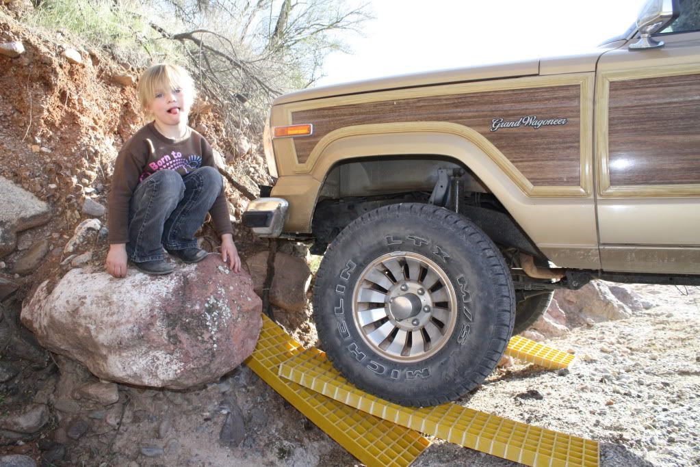

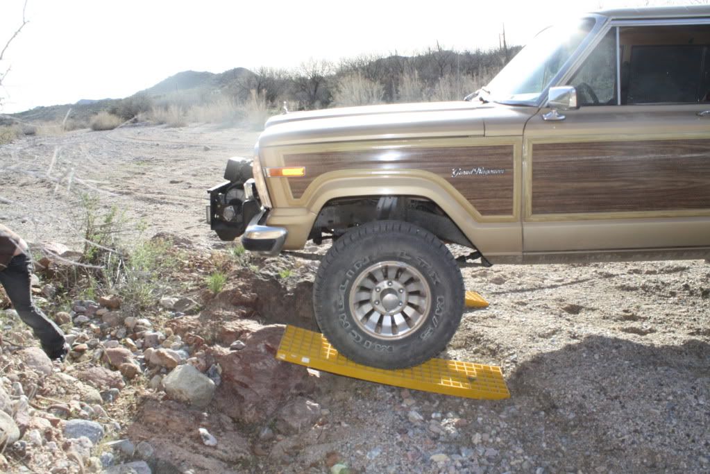

I've used mine a few times. Below is when I just couldn't get the traction to get over a rock and used these as traction aids.
Yes they splinter pretty good on rocks, but mine still seem plenty strong.
Also to note, once you go over the rock, the board will whip up and ********** the underside of the rocker. No big deal if you have sliders.
Heavy suckers... at least heavier than they look, that's for sure.
