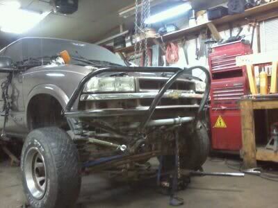

Well had some time to take some picture's of my mess.

With the holidays and work I have not really touched this project. I did get more parts to the shop the and formulate a plan. I have built a few brackets and what not in my sleepless nights. And a small collection of misc parts to use for the build. The blazer is getting drug to my house Monday. Along with the big hub 44and 14 bolt.
The parts list is this
Dana 44 4:10 gear front big hub
gm corp 14 bolt 4:10 gear welded rear
SBC 350 carbed for now
Muncie sm465 4speed with hydrolic bell housing
New Proses 205 transfercase
1350 u joints
s10 blazer rear springs up front shackle in the front
63" 1/2 ton chevy springs out back
stock s10 fuel tank 20 gallons
stock cherokee fuel tank 20 gallons
fuel switch from a 87 chevy used to switch tanks and use the factory gauge
total suspension lift 6"to 8" over stock
total over all lift 9"-11" only 2-3" taller than a stock full size blazer
camping adds done at time of build.
Front and rear bumpers
on board shower
on board air
Cb no ham lic yet
Interior lighting
Camping add on's at the time of my dad's shop
roof rack for use of RTT
winch mounted in bumper
lights
rear tire rack hi lift jack mount
