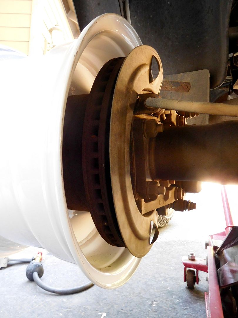

"What do you suggest for brakes? How does yours stop?"jefe writes: I've never had any woe with the disc brakes and it seems to stop the 10,400 pound truck camper fine. The only change between the 2001 and 2001.5 is the addition of larger 3 series disc brakes all around. Here is my Dana 80, 35 spline, disc brake rear end with the Stockton 10" wide wheel during clearance testing.
You can see the close clearance with a 4-1/2" backspacing
