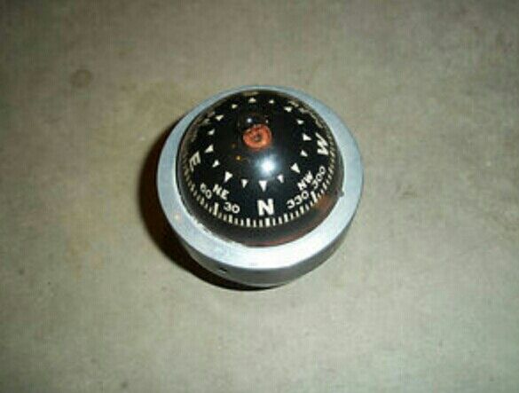

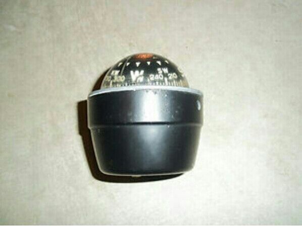

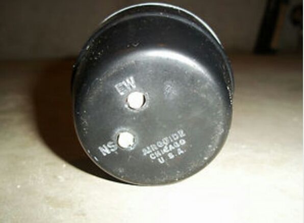

Here's the compass. Got it cheap on E*bay, (now I know why). We're trying to build our Tgb11 camper as cheap as possible (fighting terminal cancer sucks!) so I buy cheap used when I can.
That looks like it came of an old boat or plane. Amazon has a compass from the same company for $7.99 but it gets poor reviews. If you want it for navigation I would get a better quality one. That being said here's a write up I found on trails.com that may help you accomplish what your looking for. Make sure that if you are going to keep it to have it in its final position while adjusting it. Good Luck, God Bless and sorry to hear about the cancer.

Are you reading it from the top down - or from the side?
That style of compass should be read from the side - so if you have it on the dash and you read "N" - then you are headed north (even though the letter "N" is actually pointed south).
This. Most boat compasses have a 1/2 shield over the top, and all you can see is the front 1/2, even when looked at from above.
That said, I have seen some lower end dash compasses go whacky.

Yeah, it is that kind. Funny thing is, until I took those pics, I didn't see the lubber line! Now that I found it, I know what kind it is, and I'll use it accordingly. I WAS gonna mount it in such a way that we look down on it, but I think I'll mount it higher on the dash after I repaint the line.
Thanks all.
