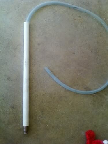

I also use the bass pro shops version of the super siphon. Found out about it from another buddy who uses it. Has been so effective that 3 other local wheelers have asked me to buy one for them since I live close to the BPS.
At ~ $8 it's hard to beat.

...A rubber hose with a brass tip with a marble inside the tip....
It's not a marble. I built a knock off with a few copper fittings and a marble, it didn't work. The whole key to the super siphon and it's cousins is a ball that is very close to gasoline in density.
That said they are the only way to move gasoline IMHO.
