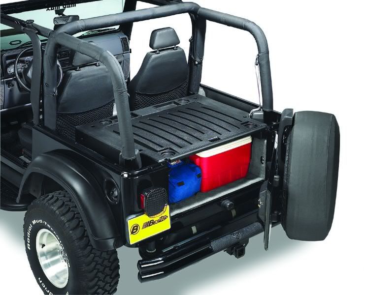

Bestop makes a nice abs molded box for the cargo area that the top slides off of so you can puit bigger stuff in the jeep if need be. One of those would work with one of the plastic hanging baskets from the roll bar in the back above the box.

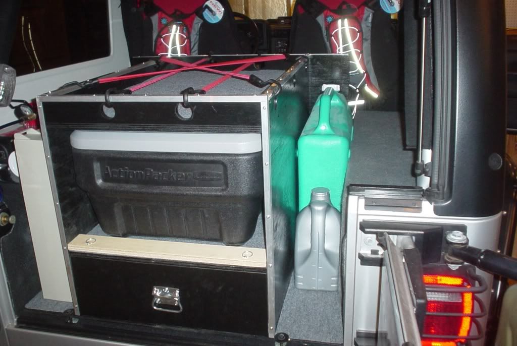

Here's my homemade solution. Granted I have an Unlimited so I have a little more room.
In this older picture you can see the inverter and CB overhead.
Darton
a few questions. What is the red thing mounted between the speaker pods? and is that a fold up toilet? How is it? I'm contemplating one for myself.
