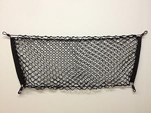

thinking of putting some cargo netting on the ceiling of my 95 RRC LWB. planning to start just in front of the back seat and go to the back window. has anyone ever done something like this on a classic? the rigid stuff was my first thought but if it were a little stretchy it might hold some items better.

I pilfered one of these from my mom's car. (She) Never used it. They work great for hanging behind the rear seats into the cargo area. I have toyed with hanging one right where the stepped roof starts in the disco. If you could weld or tack in some D-rings, these nets are since only the top end is open, pretty much a large and wide bag. Good elastics on the things, stretchy but firm.
