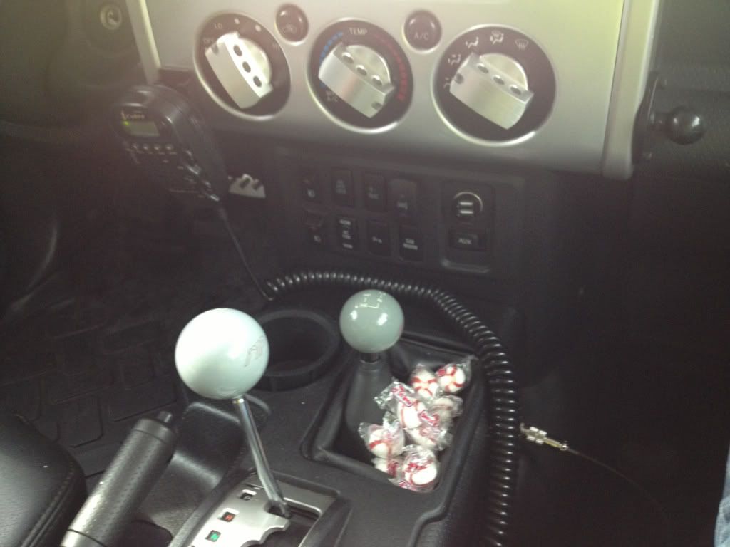

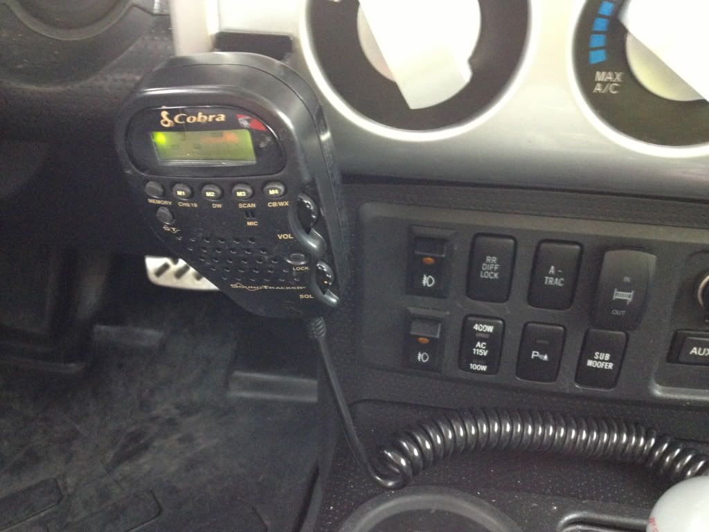

image.jpgimage.jpgI know it's a bump in overall price, but, do yourself a favor and forego the CB and get your ham license. Then look into a mobile HF radio like mine, the Yeasu 857d. With it, you not only have the ability to mount the brain somewhere out of the way and then mount a small head unit almost anywhere you want, but you now have a radio that will cover all needed radio freq's, including UHF, VHF, HF, FRS (the family radio system walkie talkies) and 11m (citizen band or CB) with a very easy "modification".
I've never understood the draw to CB's personally when a ham liscence is so easy to get and it is a tool that really can reach out for comms and for help when needed. A CB to me is only for car to car comms and that's it, but if that's what your needing than FRS is so much easier to deal with. You'll spend a lot of effort mounting a radio that is very limited in its use, IMHO.
BTW, ram makes some great mounts, I use them a lot.
