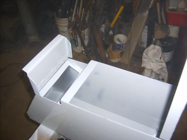

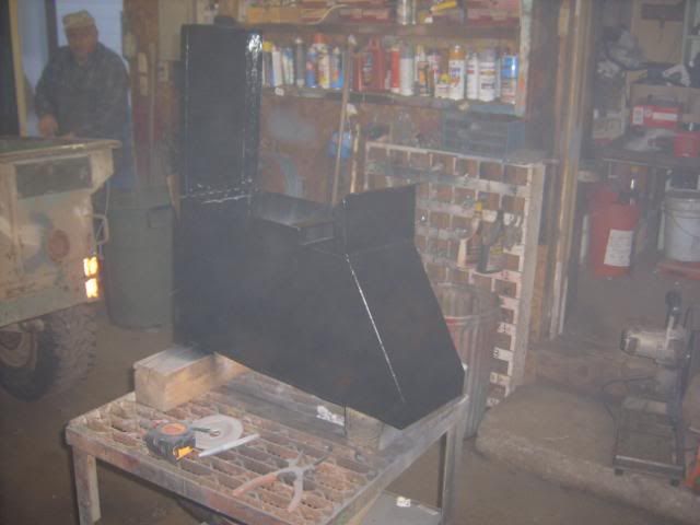

I built a locking center console for my CJ 7.
It's designed so the main lid holds the stereo lid down when locked.
I could store my carry gun inside and locked, yet have the stereo controls open and accessible.

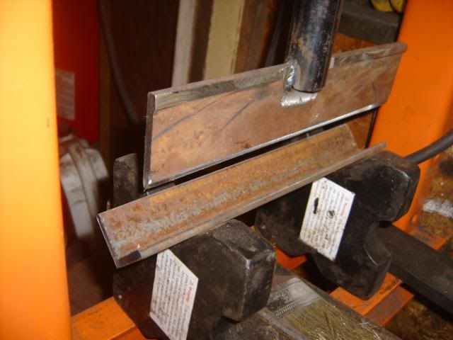

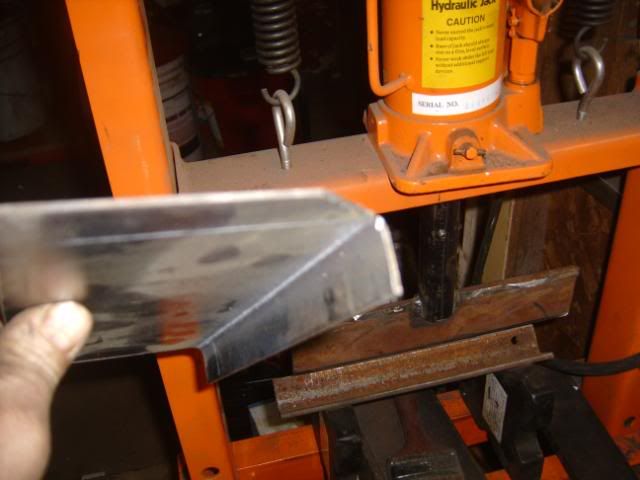

I built a couple of jigs for my press, to bend the steel as needed:
I couldn't justify the cost of some of the security consoles on the market, and I had time to kill while the Herc-U-Liner dried on my flat fenders.:elkgrin:
