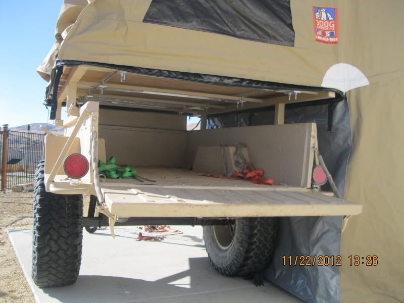

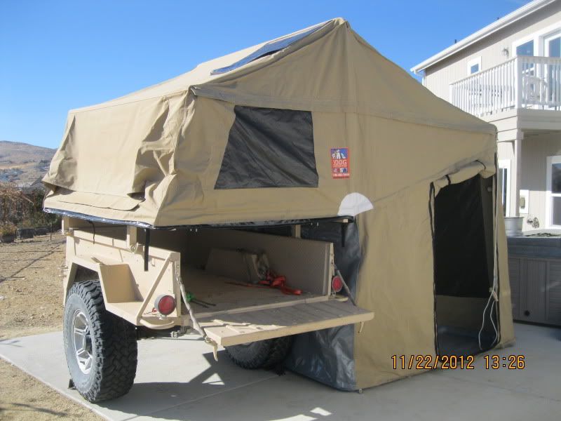

Anything is possible with time, effort and creativity. i grafted the tailgate from a 70s era toyota truck found in junk yard. Fits like a glove and offers a nice work/cook surface. Good luck.
retained the original latches/support chains (enclosed them in a rubber hose to keep them from chipping off paint). Hinges are basic door hinges from home depot.
in this pic you can see the bottom of the hinges and also, how I grafted a receiver hitch into rear of trailer.
And for those wondering, 37" BFG mudders on Hummer H2 8 lug wheels. The reason for the small lift block on the passenger spring is because they are Toyota springs and for many years due to castings, one leaf is slightly shorter than the other. So the block levels out the trailer. Before we got into Jeeps, owned Toyotas for many years. At that time the axle under this trailer was a complete Toyota front end-- hub to hub plus the steering components so we always had a trail spare if the tow rig suffered a failure. Since now have a Jeep and since the Jeep has 8 lug wheels, makes sense for trailer to match and carry one less spare tire.

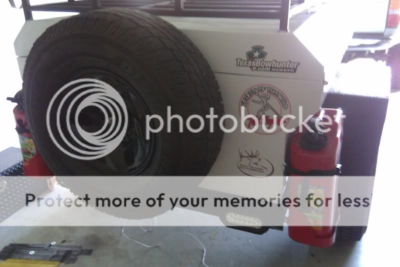

Let me know if going the fiberglass opening route is of interest to you might have a rear panel where the opening is fine with damage on one side where it don't come out of the mold clean.
Here is what one of the rear panels I'm talking about looks like,
