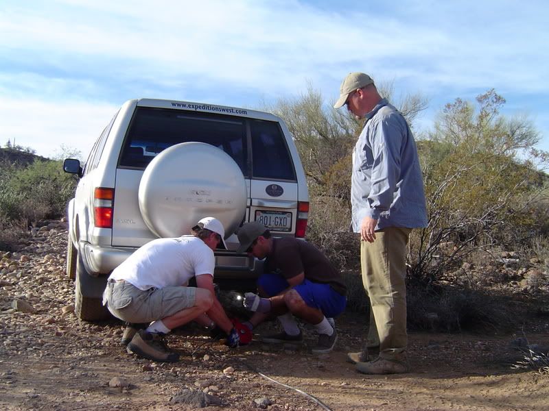

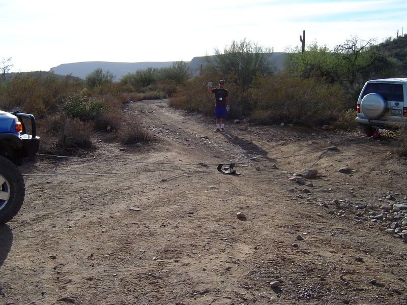

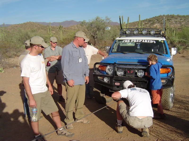

Excellent work. Nice to see someone spending some quality winching time. When you have the luxury of time, you can learn quite a bit that transfers directly to when a more serious situation presents itself.
Your winch is seeing some great use so far, from the competition at the Expediton Trophy...
Photo credit: Big_Geek from the Expediton Trophy 2007 thread.
Photo credit: articulate from the Expediton Trophy 2007 thread.
To the recovery classes...
Great stuff!
Cheers :beer:,
P
