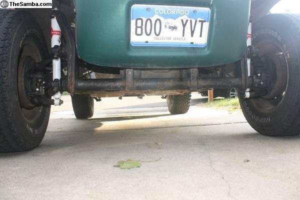

We put in a used 1968 transmission awhile back with Thing rear drums. We built the motor for it, $4k in engine alone. Car rolls on 31" rear BFG All Terrains and 235/75/15 Firestone Destination A/T fronts. Recently replaced front beam and installed new ball joints. New KYB Gas-A-Justs all around. Brakes work smooth. The only thing we ever really cried about was that someone cut holes in the tunnel to fix the clutch cable tube. Since their repair broke during my friend's ownership, we fixed the tube in the tunnel better and welded the holes shut, it is what it is.
