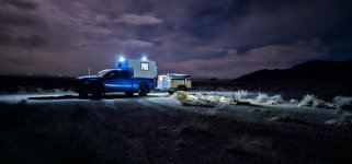

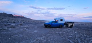

and the one other benefit of a truck camper is towing ability, truck camper can tow another trailer that carries side-by-side and other toys. In my case, I also can tow Alpacamper offroad trailer, sorry about the sag suspension, I am getting a pair of airbag helpers soon to level it out. Without a trailer, the truck was fine, but with the trailer, the rear of the truck dipped 1 1/2 inch.
the gap between the top of the truck cab and the camper is meant for the roof rack. and yes I am aware the color did not match, prehaps i need a color wrap.PSX_20221126_234952.jpg

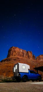

PSX_20230514_221402.jpgPSX_20230514_221750.jpgPSX_20230514_221440.jpgPSX_20230514_221506.jpgPSX_20230514_221533.jpg
spent the 2023 easter in Moab Utah0!
been overlanding from Oregon to California to Nevada to Utah to Arizona and back to California! Mega road trip with Alpacamper truck camper!
