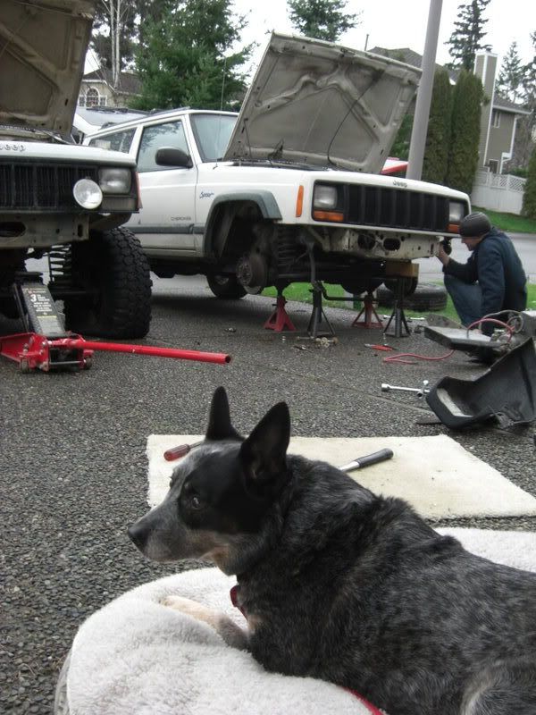

My Blue Heeler Abby overseeing out progress:
