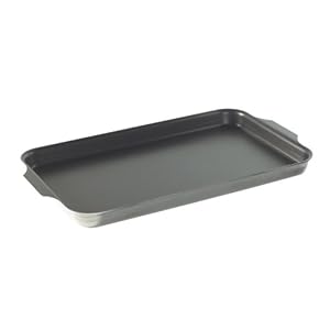

hmmm so you guys have had them work well. Anything special to it? What grills are you using if that makes a difference? A couple posts above is a sweet grilling set up with the power to melt steel if you need to do some sand cast parts on the trail haha. Its out of my budget though and needs more umpf then my 1lbs propane bottles. Seems like a grills output would govern how well this would work.
Chris the dual burner stove and griddle/grill top is a proven winner. I would not rule out that set up for a future purchase since its so versatile and has >50 years of successful camping meals, but I've got a propane BBQ grill that I use already. My mission is eggs and hash browns for breakfast for hopefully just the price of a griddle.
I found this deep dish bad boy and will try to update the post with results when I'm home in a couple months. Just web wheeling and day dreaming for now.
http://www.amazon.com/Nordic-Ware-B...d=1380287888&sr=1-3&keywords=aluminum+griddle
