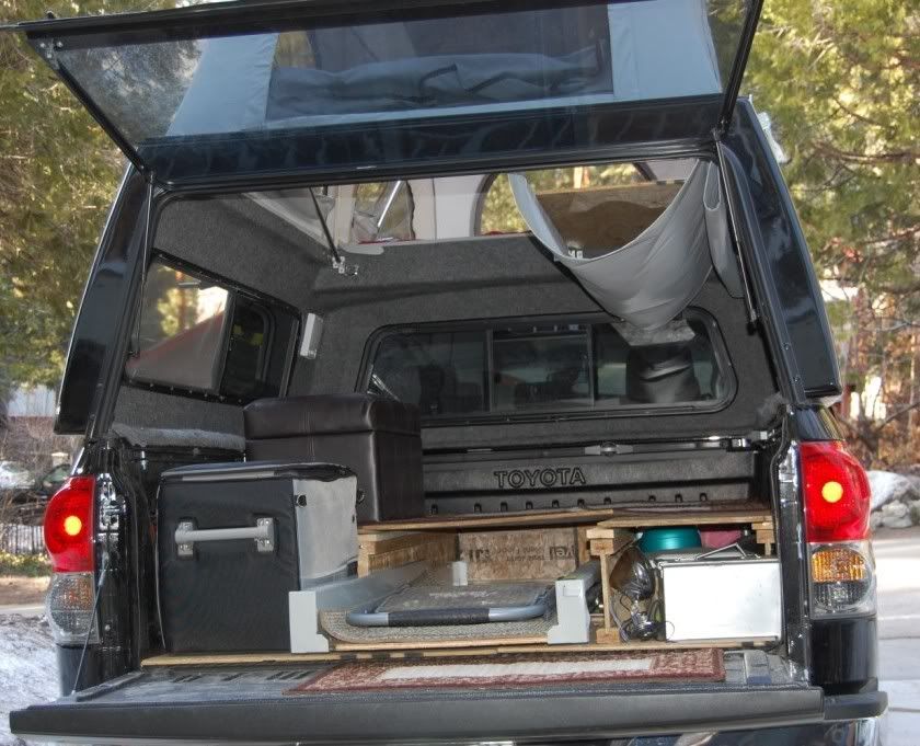

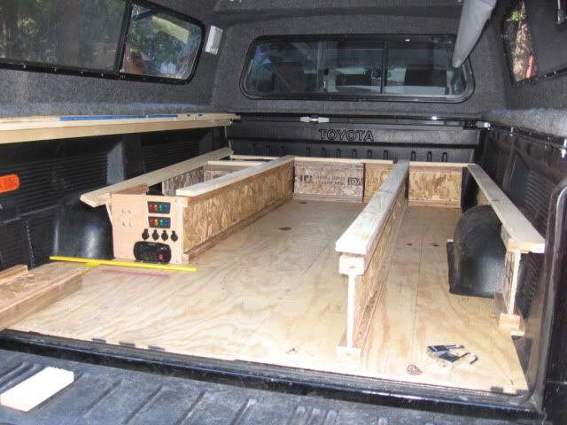

I think this deck looks like a great idea for storage, much the same idea as what I was going for when I built my raised floor. As I look thru their website it looks very stout, and highly customizable. I wish I’d seen it before I built mine, I’m no carpenter! Modular was important to me because when I first got the truck, it was on a lease.
One of the issues with longbox trucks is accessing all that space from the end of the bed, 8ft away. I couldn’t find drawers or even drawer slides long enough to do the job, and couldn’t see paying the $1000+ for the cargo bed slides like this one. So I looked at RV solutions to the problem, and found this, which is what I installed in the center section under the floor. It holds all my kitchen stuff and slides easily. Looks like your deck would accommodate a slide underneath if you wanted it.
I wanted my fridge at the rear so I to could get at it while outside, and cut a notch in the floor that fit it. Then VikingVince suggested that I leave a space next to it at the truckbed floor level for getting in/out, so I didn’t have to resort to contortion getting in and out through the rear opening. At one time he had raised his center section at the rear to accommodate a pullpal, and then wound up removing it because it limited entry/exit on his Tacoma. I’m glad I did it, gives me somewhere to throw dirty shoes and so on before getting up into the main area.
Anyhow here’s what mine looks like under the floor, not quite finished here:
And how it (mostly) looks now:

Thanks for the pics, that looks like a very useful setup. I like the stinger as a step idea, it sounds like you've had some fun in your truck!
As to the deck, I guess it depends on how big your stuff is and whether the smaller compartments would work for you. I think leaving some room at the end is a good idea, that's pretty much what I've done. Longbox gives you that option, wouldn't be practical with less length. I kept the side compartments on mine long and skinny for storing tables, chairs, etc.
Also it does look like the deck is built to fit just over the wheelwells, not higher like your current setup - so you'll want to take that into consideration as well.
