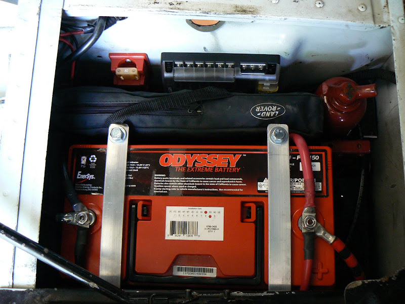

I recommend forgoing a dual battery system in favor of one very large battery (namely the Odyssey PC2150) supplemented by a jump box.
It fits quite nicely in the 90/110 battery box.
Oh, nice photo. I have been wondering where I should put my jack.
I have been debating dual battery or the biggest battery I can fit.
Abel Villesca
JSQ, that Group 31 looks like the perfect size. Where did you get the battery tie downs? That's a clean looking battery box. :costumed-smiley-007
