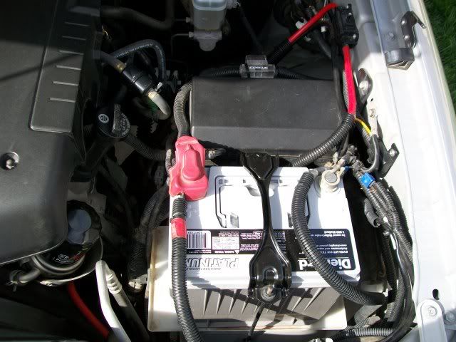

Here's another option: Diehard Platinum Group 65. Same price, same reserve capacity, except it has 930 CCA. Only minor modifications are needed to make it fit:
1) You'll have to trim the raised lip off the front of the battery tray since the Group 65 is slightly larger front-to-back than the OEM battery. I did this in about 30 seconds with a pair of tin snips.
2) The OEM battery hold-down strap has one of the hold-down hooks integrated into the strap; you'll have to drill out the hook and replace with a set of aftermarket hooks. The battery is taller than the OEM battery, so you'll need longer hooks. My suggestion is to get the longest ones they have at your local parts store and then cut them to length after they're in. The hooks should be $5 or less at any parts store, and it took about 5 minutes to drill out the OEM hook from the hold-down strap.
3) You'll have to get extensions for the battery cables to be able to reach the posts on the far side of the battery (probably will be the same with the Group 34 you mentioned). I got the parts needed from Remy Battery (thanks to DarkHelmet here on ExPo for the recommendation). I used sticky-back zip-tie anchors to hold the cables down, and even with all the heat from the engine, hot/cold ambient temps, humidity, and numerous washes of the engine bay, they're still staying in place perfectly.
Side Terminal to Post Adapters (P/N 5515): http://www.remybattery.com/Side-Terminal-to-Post-Adapters-P4950C1300.aspx $5.04
Extension Cables (P/N 5505): http://www.remybattery.com/Top-Post-to-Side-Terminal-Conversion-Cables-P4947.aspx $25.95
Even if you don't decide to go with the Group 65, you can use these same parts to solve the problem you mentioned with the Group 34.

I like that setup you have for your aux fuse box. Can you still get into the stock fuse box with out much fuss?
soonenough
Bringing this one back from the dead...I was back in this thread trying to find a Remy Battery P/N and saw I never answered your question. It takes a minute or two to undo a couple of the cables that are running to the main fuse holder and fuse block before you can remove the OEM fuse box cover. It's not ideal, but it's been working for probably close to 4 years without any ill effects. Long term, I'd like to change it and use a Bussmann 15303 fuse/relay block, but it's not at the top of the priority list.
