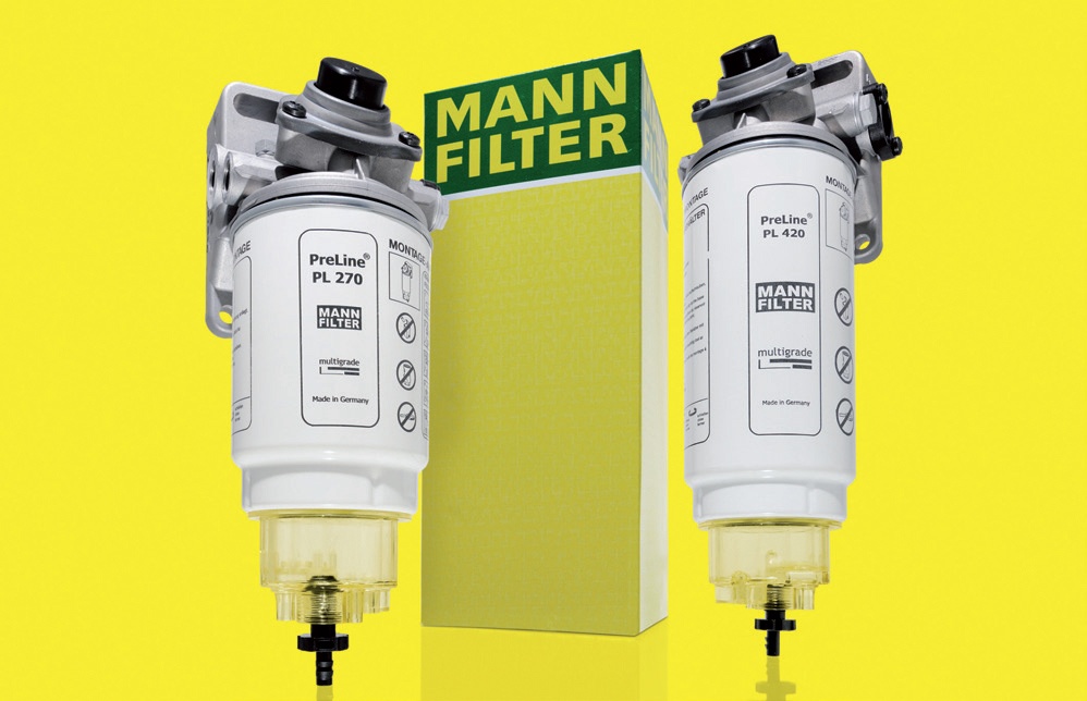

I am looking at 2 systems, Fuel Manager Standyne FM100 filter kit with water sensor or MANN+HUMMEL PRE-LINE kits.
1: https://www.dieselcare.com.au/service/filtration-systems/
2: https://catalog.mann-filter.com/media/productassets/MFPI086_en_PreLine.pdf
I like both kits but the MANN is a pretty neat system and looks well made. I could most likely use a different filter on it as the filters than come with are 3-5 micron. I think I prefer 30 micron before feed fuel pump to main filter. I feel that a 3-5 micron (checking on if they have a 30 micron or I can fit another brand 30 micron) would fill up quickly as a pre-filter. Might be better as a secondary. Both will have water sensors. Fuel manager, I'd go with a flashlube sensor.
Anyone using these?
Here's one in a touareg.
If anyone has some good advice I would appreciate it.
