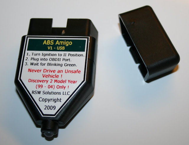

A new product has been developed by RSW Solutions and is now available to consumers. The ABS Amigo communicates directly with the vehicles ABS system and allows for DIY diagnosis.

The ABS Amigo retails for $195 and can be kept in your tool kit for repeated use. Simply plug the ABS Amigo into the vehicles ODBII port, wait about ten seconds for the red and blue lights to cycle and the green light to flash, remove the ABS Amigo and connect it to your home computer using a mini USB cable. The ABS Amigo acts as a flash drive and stores a text file of the last three faults indicated by your vehicle’s system.

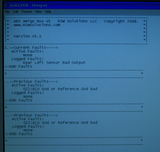

My test showed that there were no current faults however in the past there had been a fault signal from the rear left wheel sensor. The hard fault left the ABS and Traction Control system disabled although there was no real problem with it's functionality. The ABS Amigo cleared the hard fault and the entire ABS system reset in about ten seconds.
