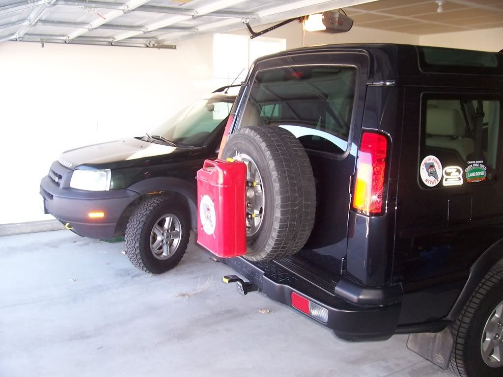

I hang my off the rear tire.

FortyMileDesert
I built a similar mount on my spare a few years ago. Eventually the spare mounting frame cracked. Since then when I do need to take along a jerry can I just bungy it into the cargo area. I do a lot of long distance treks but it's amazing how seldom I ever really needed spare fuel. Most times I used it to fuel up the Jeeps that were along.......

I like the idea of mounting it off the spare tire.
RonL, Did you buy that mount or make it?

DiscoveryXD
I wouldn't mount the can on the back of your tire carrier. The wieght plus the leverage is going to be hell on that back door.
x2 The extra weight will be brutal on already suspect Disco door hinges.

Chucaro
I agree with that, in rough terrain even the original holder would not last long.
A separated wheel carrier is the way to go
