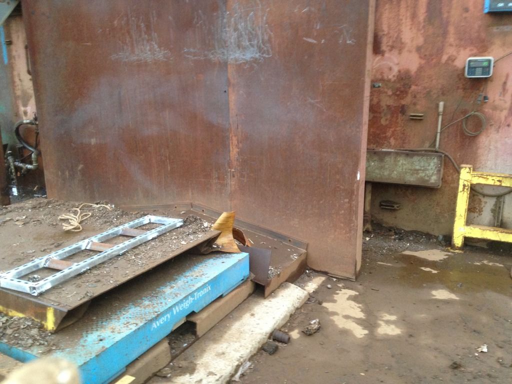

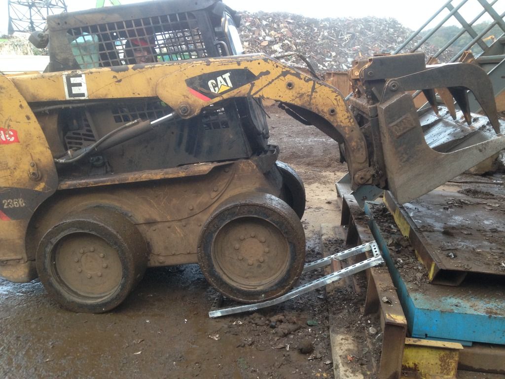

got a little over zealous and threw our bobcat at work on top of it, just one, not a pair. The bridging ladder held up great till he hit the middle, then he bent. I'm pretty happy with that, being as the curb weight is 7,030lb on this bobcat, and the front end is being held by one bridging ladder (they're mount wheels, both on the front ...next batch I may use 3 sections of unistrut, instead of just 2...either way...
the pictures...
I know hes no longer in the center, panicked and backed up a little.

I decided to use the unistrut because of the open U shape makes it lighter, but I knowing it would be weaker and more prone to splaying out is why I added tabs on the back side, reinforces the open end, and gives it a grabbing lip. for the ground side. For a first attempt I'm pretty happy with it, minimal bending with the entire front end of a bobcat resting on top...from Cat their 7,030 pounds without the bucket or occupant, so I'd say it was about 8,000 give or take...my Pathfinder with a maxed out weight is 5,150, so about 3k lighter, and would be only on one corners weight, not 2
won't know for sure till I build some more of them, but worked better then I expected.
