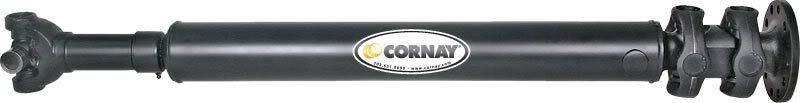

Frank, you should be fine. If you're not hearing any vibes on the street, you will likely not have issues. At some point, you will probably want to upgrade to an SYE and aftermarket shaft like a Tom Woods or JE Reel. I just picked up a JE Reel to replace my wasted Woods CV...but it lasted 80k miles of hard wheeling (you know how I roll), AND never failed, just made lots of noise for 2500 miles to and from Moab.
Here's my new shaft, a Cornay joint equipped JE Reel shaft...BLING!
