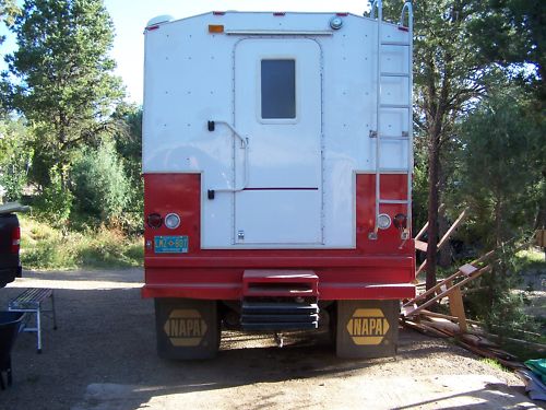

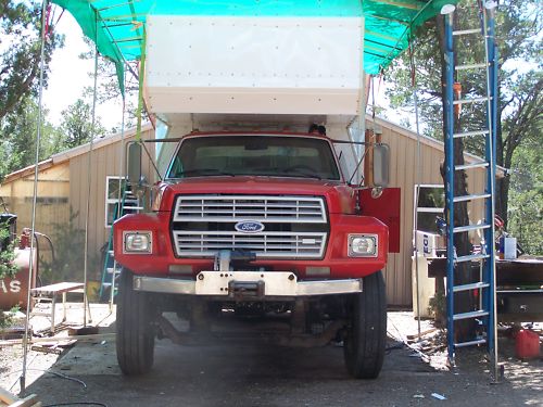

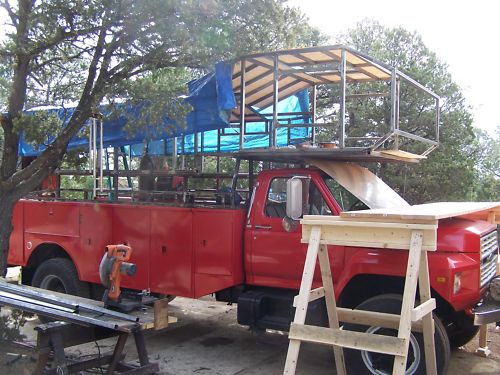

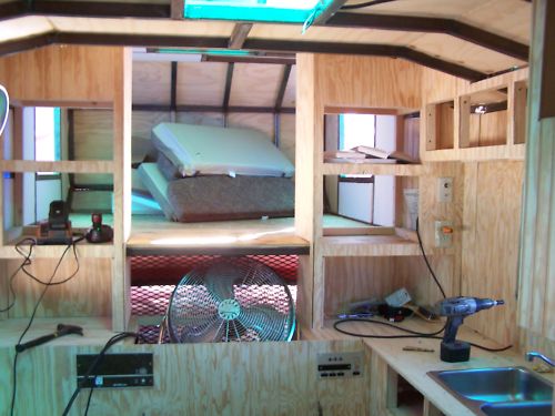

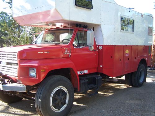

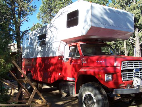

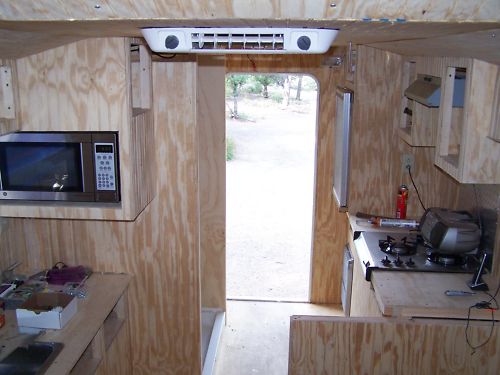

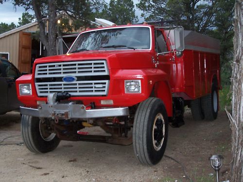

cool rig..build photo's not mine/no connection w/ seller info only..
1985 FORD F 8000 FIRE SERVICE TRUCK ,CUSTOM DESIGNED AND BUILT, FOR CAMPING ,HUNTING, FISHING WORK OR PLAY , 10.5L 3208 TURBO 250 HP , CAT DIESEL ,ALLISON 653 AUTO TRANS ,EATON 488 DIFF , TWIN DIESEL 50 GAL RECIRULATING FUEL SADDLE TANKS,. HD ELEC .SPARE,. 4 NEW REAR TIRES ,HANKOOK Z35 A ALL WEATHER DRIVE TIRES ,. HD COOLING SYS , 15000 LB WARN WINCH , CLASS 3 HD REAR HITCH , WITH 2.5/16 BALL, 4000 WATT GEN , TWIN 40 LB LP TANKS ,EXTERNAL LP GRILL , {CAMPER SPECS} ALL STEEL 1/1.5" HT STEELWELDED FRAMING ,. FULL FOAM INSUL PACKAGE , FLOOR, ROOF ,SIDES ,. PROP & ELETRIC HEET , ROOF AIR ,. ALLWOOD 3/8"PANEL PLYWOOD INT , ALL MARINE 1/2" PLY WITH AIR CRAFT ALUMINUM EXTERIOR . POP OUT EMER WINDOWS AND HATCH,,3 WAY FRIG 3 BURNER STOVE MICROWAVE , SAT DVD TV , AM FM ,SIRRIS XM STERIO , QUEEN BUNK WITH A $ 2000 ,00 NEW SLEEP NUMBER BED ,. LARGE 34"X48"SHOWER, AND A RV TETFORD FLUSH POTTY ,. 12 AND 110 VOLT LIGHTING , POWER INVERTOR ,SOLAR ROOF CHARGE PANELS , , AND MUCH MORE ,. THE CAMPER IS VERY SOLID ,SELF CONTAIND ,ANTI VIBRATION ,QUIET ,ALL GLUED AND SCREWED TO GATHER ,, CAN FUORD UP TO 4FEET OF WATER , WILLTOW ALL MOST ANY THING, LOVES NARROW MOUTAIN ROADS , WILL RUN ABOUT 60,TO 65 ON HI WAY AND HAS A VERY LOW FIRST GEAR , AIR BRAKES, DOT APP LIGHTING , COBRA CB SSB RADIO ., AM FM STERIO ,. I DESIGNED HER TO TAKE TO ALASKA , I WANTED A TOUGH TRUCK THATS GITS GOOD FUEL MILAGE AND DESIGNED HER FOR THAT,. TOOK ME 6 MONTHS TO BUILD HER ,. AND WILL GO ALL MOST ANY WHERE AND IS NOT BOTHERD BY THE WIND ,SO I PICKED BIG RED, BUTSOMETIMES THINGS DONT WORK OUT ,SO I AM STUCK AT HOME FOR A WHILE, ,I ALSO HAVE ALL CONST PICTURES .,,ENGUINE AND TRANS WAS REBUILT BY CAT 3 YEARS AGO, HAS ABOUT 55000 ON IT ,,. IT IS VERY EASY TO DRIVE JUST LIKE A PICK UP BUT A LITTLE BIGGER TIGHT TURN RADIOUS 12.4"HIGH 24'LONG AND{NO CDL REQ } WEIGHT IS 18000 LB
