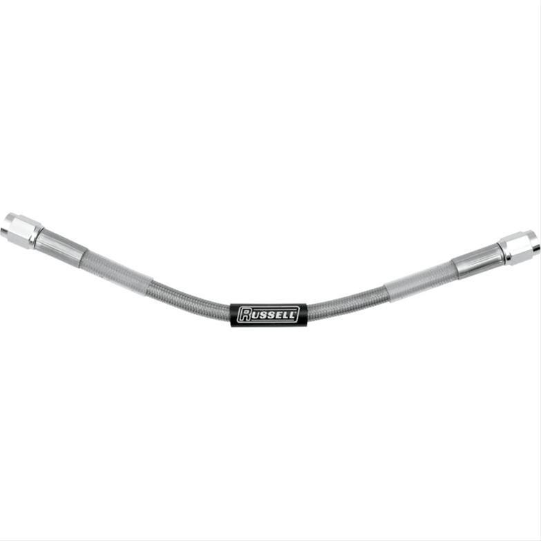

I used generic stainless braided lines for mine which are available in any length with universal fittings on the ends. Then all you need is the proper size banjo fitting for one side, and the proper adapter fitting for the other side. I got them at Summit Racing, but I'm sure any speed shop would keep them in stock.
something like this
this is similar to what I used

Thanks for the pics, I don't think the montero using any sort of banjo fittings, they're like this:
flare-nut-wrench-

Almost forgot about custom lines, i had some made locally at a hydraulic hose shop for one of my Gen 1's and my Hilux. cost was roughly $1 per foot and $5 per end, i got the steel braided rubber coated lines. They don't look as cool as the hotrod stuff but they do the job.
