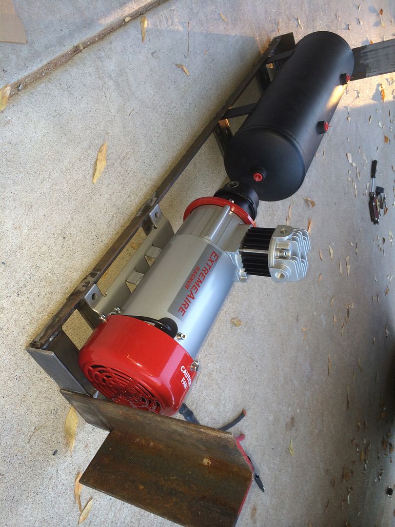

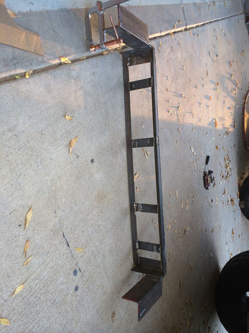

I made a plan on where I wanted it, so I needed to build a crossmember to make it work
Here's what I came up with
It fits perfectly between the frame rails attaching to 3 threaded holes on the frame each side. It doesn't hang below, the rails at all. I will make a skid plate to protect it and put heat shields under the exhaust pipe. I intentionally mounted the heavier compressor on the passenger side, to not make the FJ lean any worse.
Its now painted and will be install tomorrow. I will take more pictures of the electrical, air routing when it's done .

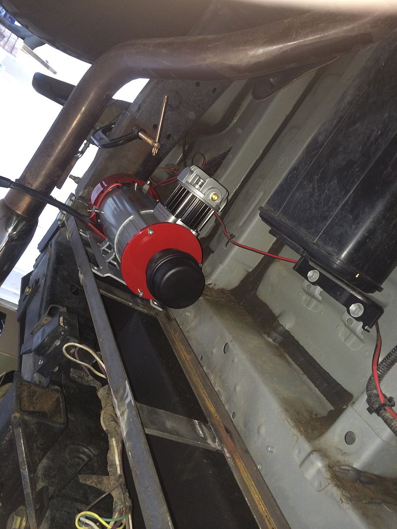

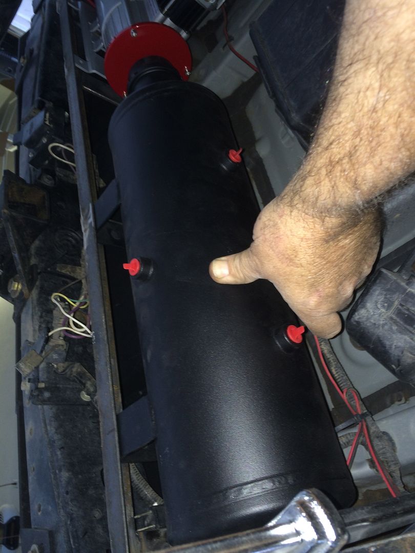

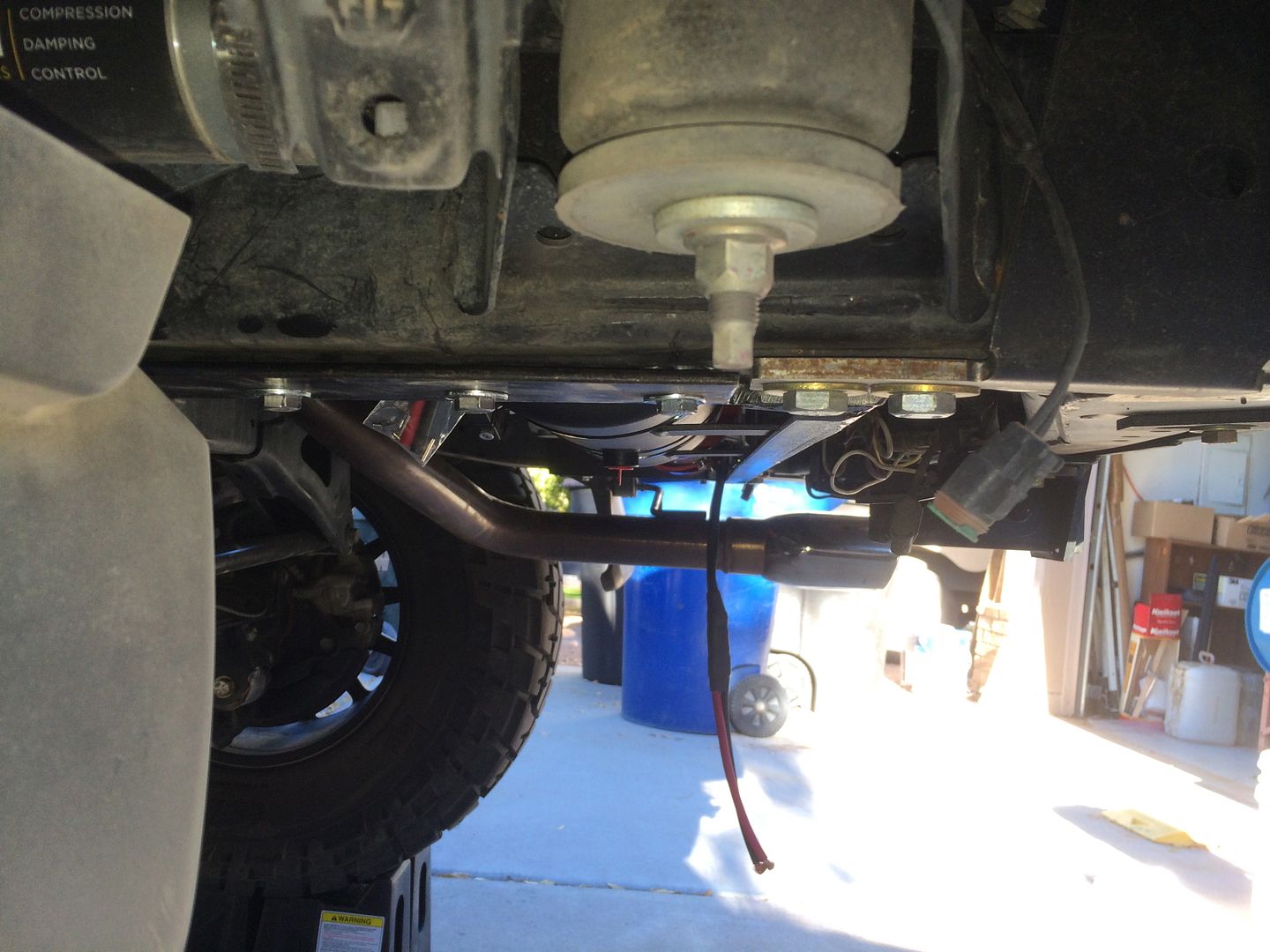

Part 2 is complete. After test fitting the bracket some adjustments had to be made. I actually wheeled with the bracket in place yesterday. The adjustment I made was making sure there was a separation between the compressor frame and the body above it. I thought I allowed enough in the original fabrication, but after pulling the bracket, today I saw rub marks on the body above the frame so now it is spaced more.
The compressor and tank were mounted , pressure switch plumbed in, blow of valve attached and everything from the compressor to the tank is now complete.
The hard stuff is done.
Next phase is plumbing the air fittings and running all the electrical. I hope to have it running this week and do some testing.
The entire unit together weighs 47# . I'm not sure what a CO2 set up weighs full, but if someone could give me the weight, that will be a good comparison.
Here are some pics mounted

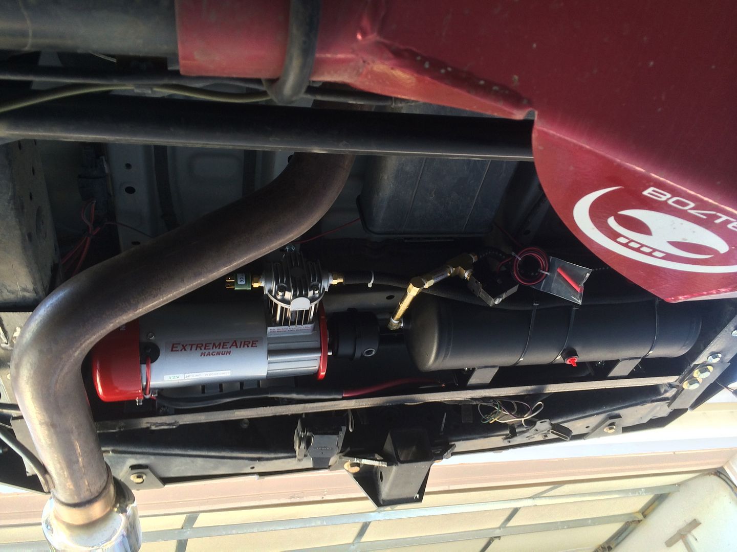

wikid
I made more progress today. Air lines in place, on opposite corners of the truck, 4 awg ran to the engine compartment, relay mounted on the cross member over the pan hard bar. Everything on the rear is now wired and ready to go. Still need to punch holes in the bumpers for the air chucks, and wire in the 80 circuit breaker, under the hood and I can start pumping air
wikid
All ready to go. I aired up a 35" General Grabber on 17" rim from 0 to 42 PSI, in 3 minutes flat

I think I will make some sort of skid below the entire area. Nothing to elaborate, but at least to keep some of the heavy muck off of it. Then a small outer shield for separation between the skid and the exhaust. A double layer so to speak
The frame had 3 threaded unused holes, that were perfect for mounting the cross member to. The hardest part was centering them , with the cross member in place . They are 8MM x 1.25 thread. I just happened to have some SS bolts laying around, so I used those. I decided to keep it all fairly standard to the FJ and used 8mm x 1.25 bolts for mounting the tank and compressor to the cross member. I actually welded the bolts through the back side of the new cross member and used washers and nylocks to secure it. I just figured the nylocks, would keep it from any vibration issues. This keeps my tool selection the same, throughout the truck.
