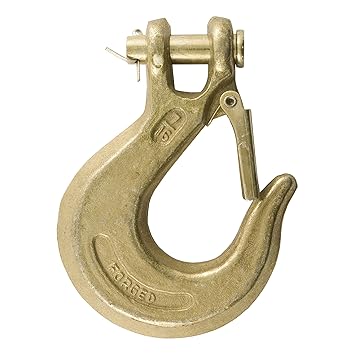

Antichrist
I don't get these. What's wrong with a hook?
Don't ask such a stupid question.
Everyone knows that if you have a hook the only way to rig is like this.
At least that's apparently what the factor 55 people think.

How is the thimble with a shackle safer and more secure than just a shackle?
How would you have just a shackle? With out the thimble you would have a hook and strap or hook and shackle. ( 90% of winch lines come with hooks assuming that's what you have)The thimble goes on the end of your winch line instead of the hook. It is a much safer setup. It lessons your chance of spooling your hand in the fairlead by having a built in stopper. And by using the thimble and shackle you now have a closed system. Not sure if that clarifies it. But if you go to their site it explains the benefits. Hope that helped your question.
fishEH
Factor 55 is a bling component. None of their products are any safer than the already available alternatives. In fact, most times using a Factor 55 product requires the use of an additional connection device which introduces another point of failure.
Take your basic winch pull to a tree strap. With a tube thimble you have to use a shackle; 1 connecting link. With a hook you just use the hook; 1 connecting link. With a Factor 55 you have their product AND a shackle; 2 connecting links.
Hooks are plenty safe when used properly. Same with tube thimbles, regular shackles, and synthetic line.
Pretty easily.
...most times using a Factor 55 product requires the use of an additional connection device which introduces another point of failure
Most times? I can't think of how you can ever use your winch for recovery without the use of another connection device.
While the stuff is bling, and if the OP feels it answers a requirement, great-I still feel like it is a solution looking for a problem.
Very true.
And I have to admit that they did well, reinventing the wheel to make it more complicated and then convincing people to buy it for over $100 even though you still have to use the simpler $25 wheel for your $100+ wheel to work.
