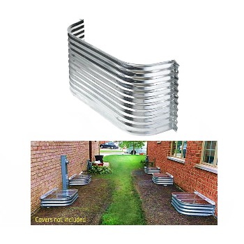

Okay, so I've got most of this figured out. But the fenders? First off I don't see alot of fenders designed to cover a foot of tire esp. not at 35" diameter. What I have found are galvanized window wells' that are 37" diameter at 16 tall and 16" 18" and 24" wide. So these are looking pretty reasonable. On top of that at 25$ a pop seem priced right for something that'll get beat up.
What do you all think? I'm thinking I'll make some brackets for proper support. and mount them to the side of the trailer.

... I was thinking about using steel car ramps for fenders on my motorcycle trailer.
What a wonderful idea. I love things with multiple uses. It might take more work than just mounting a set of trailer fenders. They might be heavier, but you can bet they would be durable. You have a nice cradle on the top to support a spare tire.
I am not sure the radius would be a good match for bigger tires, but I like the concept.
Be sure to post if you do it. I WOULD like to see it done.
Maybe a custom set of ramps built from aluminum? Hooked and latched to the side. Hmmm...I can kind of see it. What a great idea.
R_Lefebvre
I just built my fenders from scratch. If you don't have the ability, you could probably pay any local metal shop to make something up for you, shouldn't cost too much. In any case it'll look better than using window wells for fenders.
