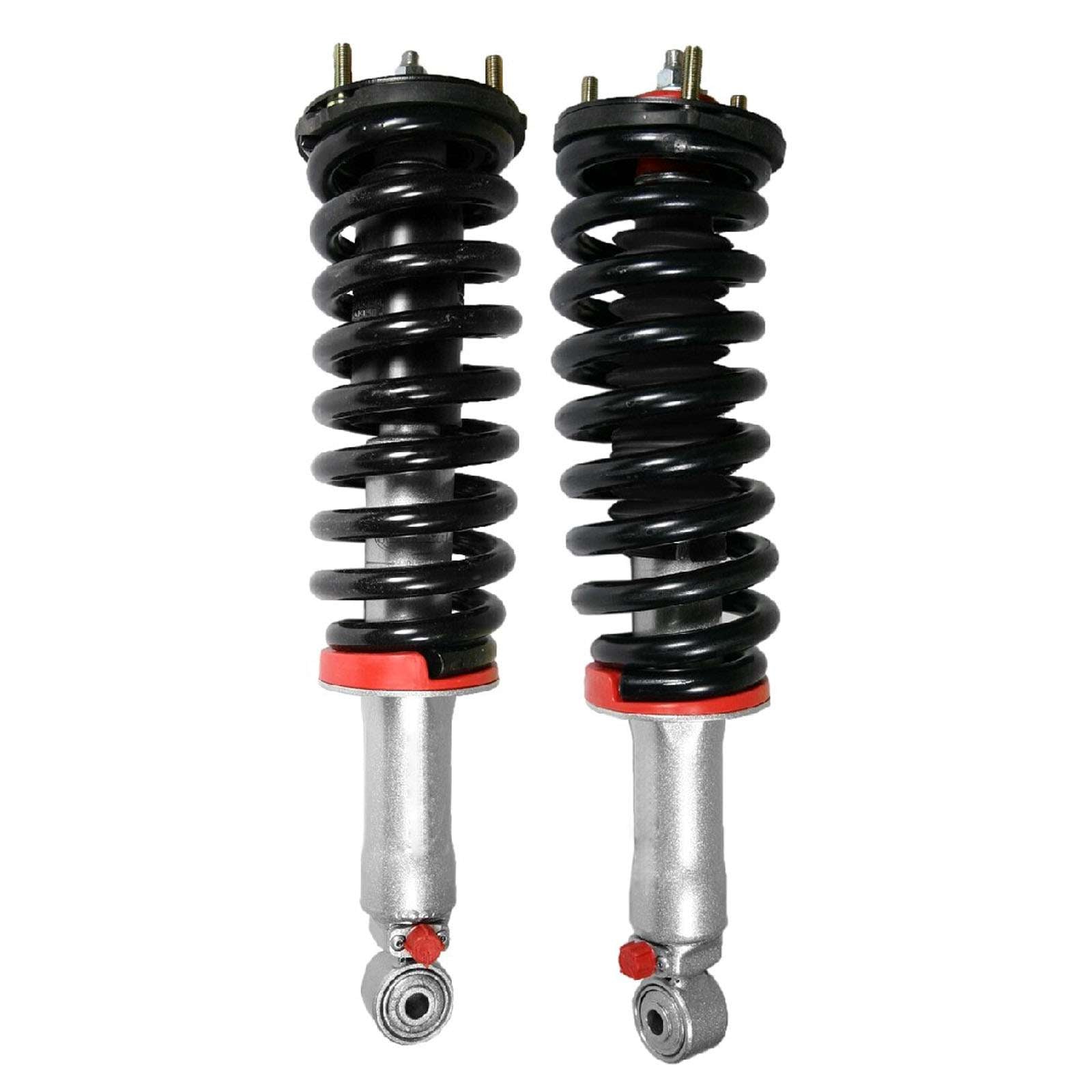

I'm actually toying with the idea of coilovers up front just to avoid the need for a spring compressor, but I'm still not sure how much i want to put into this project, or what I'm going to do with it in the long run.

Look around for used tundra coil overs for the front, you can find people selling them used on tundra forums, MUD, and on this site.
