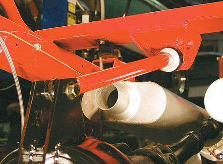

I need to figure out a wrap bar that will work with a 79. Any suggestions?

I would build something like the "Wrap Trap":
If you plot the pinion angle vs. travel in a leaf spring system you'll find that the pinion angle doesn't change very much - if at all - thru the whole range of travel.
A MS-ME friend of mine did this development prior to deciding what sort of system to either buy or make for his EB. The Wrap Trap essentially turns the front halves of the springs into lower links of a 3-link system.
The anti-wrap arms with two mounts on the axle put huge loads into those mounts. These 'A' type arms force a rotation which puts an S-curve in the spring that wouldn't be there otherwise. To be honest, I've not had much success convincing those indoctrinated by POoR to use the Sam's/Kopycinski design that it isn't all that great of a design. Then they wonder why they have to use a 3/4" G8 bolt at both axle mounts to keep them from shearing off.....
I'm very interested in this. I agree with your statements on the two axle mount systems. It seems like over and over again I hear about failure and the need to use heavier hardware. I also like this design because with my 79 I have a gas tank mounted underneath there and am limited in space. I'll read more about it. Thanks!
