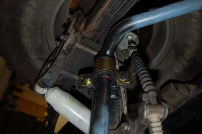

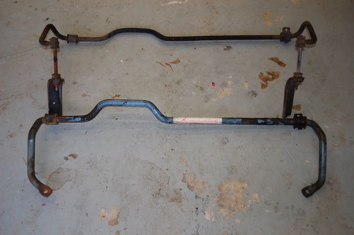

I installed sway bars when I rebuilt my rig and it made a BIG difference on the road. With new shocks and re-arched springs it handles like a sports car now....kinda. Mine's not sprung over though, and the sway bars are over-sized aftermarket units, 27mm in the rear. Disconnects are a good idea for tricky spots.
vs stock:
rear installed:
Where did you buy your aftermarket sway bars?
I didn't, they came on an FJ60 donor I bought. They are made by GT Suspension who doesn't seem to be in business anymore. I did a little research and all I could find was that they probably came out of Australia and sold by Man-a-fre. Man-a-fre now still sells aftermarket sway bars, but by a different brand.

Wow what a differance from stock, I just found a set off of a FJ62 so they will go on as soon as I can clean them up.
