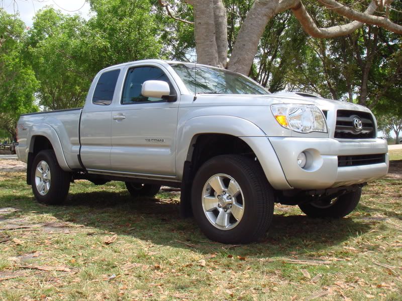

Since my truck is 4x2, it is geared more for road trips, camping, and toy hauling. This is my first truck, and I can say my next truck will definitely be 4x4. For now though, I am fully enjoying this one. I plan on using this thread to document modifications I have made and trips I take with the Taco.

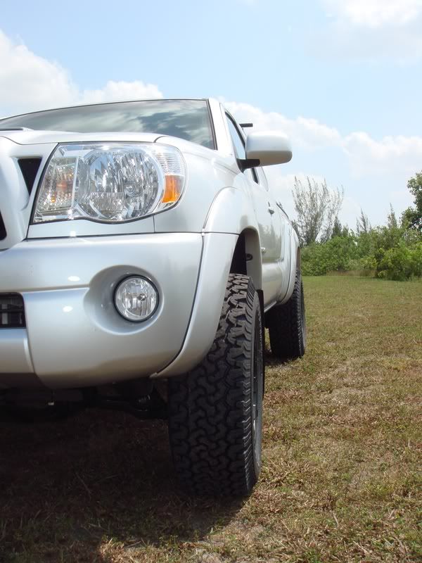

Front IFS: Bilstein 5100 shocks, TRD Coils
Rear Axle: Bilstein 5100 shocks, TSB 4 pack springs, Limited Slip Differential

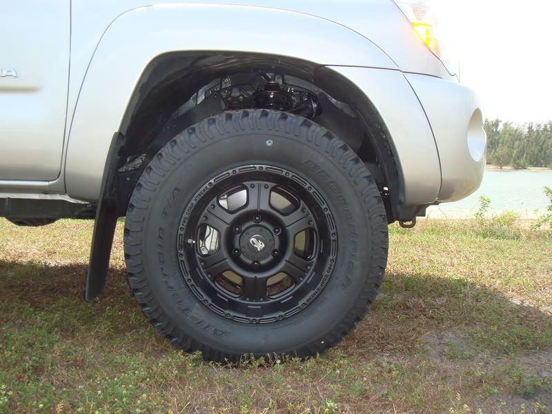

Tires: 265/70/17 BFG All Terrain KO
Wheels: ProComp 7089 Cast Aluminum 17x8

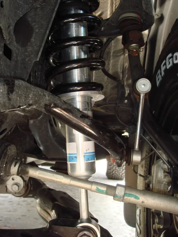

Bilstein 5100's on all four corners and Rear TSB springs installed. The front shocks are set at 1.75" of lift. With the addition of the rear TSB springs, the truck sits pretty level.

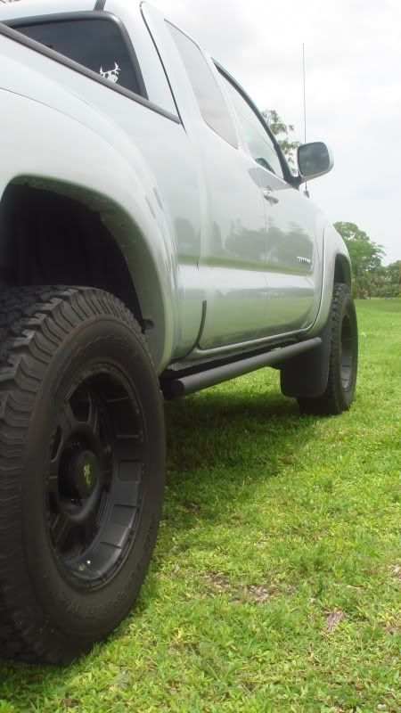

ProComp 7089's and BFG All Terrains.
Demello Offroad Round Bolt-on Sliders.

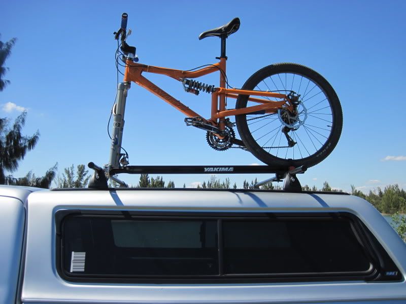

Yakima rack system with Viper bike mount. I decided to go with the roof rack rather than a hitch mount so I wouldn't block access to the sleeping platform when I go camping. From personal preference, I went with a fork mount as I feel they are a little more secure. The Viper works well and is compatible with my disc wheels.

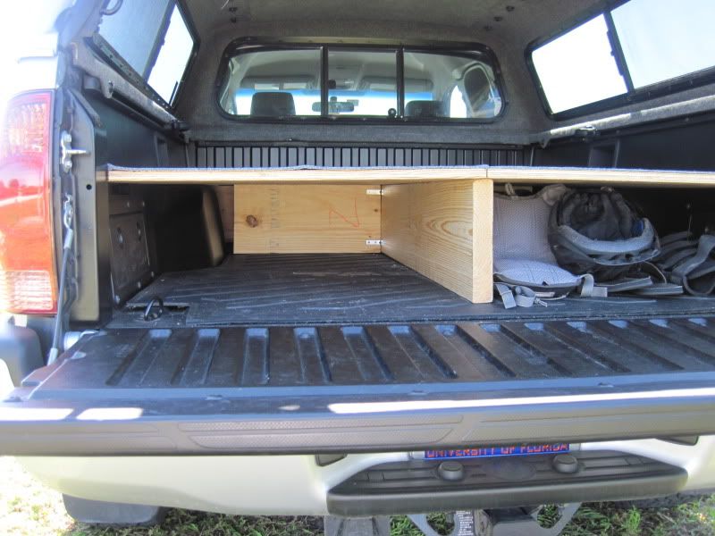

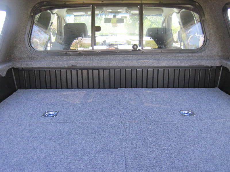

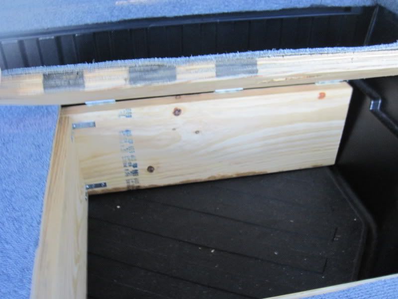

Sleeping Platform. I was inspired to build a sleeping platform after seeing many set ups on this forum. My design is rather simple, a center stringer that runs the length of the bed, a support board at the end of the bed for the trap doors to attach to, and a middle support for the trap doors to rest on. Nothing is attached to the actual truck bed, but the boards were cut snug enough that there is no room for movement. The deck is made up of four parts, the two trap doors and two larger pieces. I used trap door latches I found at Home Depot for the handles. The carpeting came out alright. I used spray adhesive and a staple gun to attach it. Didn't bother wrapping it around the edges, but I still think it came out decent
Trap Doors at back of the bed:

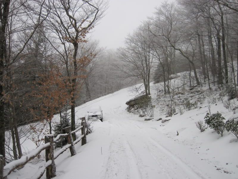

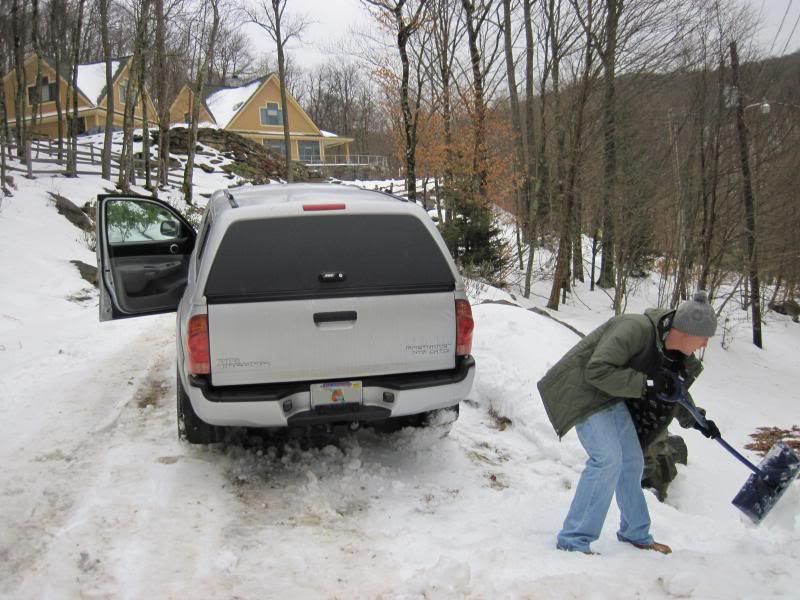

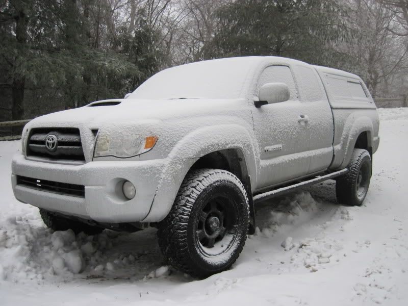

I have only gotten the truck stuck once so far. I took a trip up to Beech Mountain, NC to see a friend this past January. He lives high up on the mountain and his driveway is pretty steep with a switch back up at the top. Even in 2Lo, I didn't make it very far up the driveway with the ice and snow on it. I lost forward momentum and slid sideways off the ruts into some deeper snow and had to dig it out and back down. The taco had to spend the night at the bottom of the driveway. This was my first time driving on snow so I was taking it slow. Not sure if i could have made it if I carried more momentum into it.
My buddy helping me with some shoveling.
My friend has a 4x4 Xterra that climbs right up. This is when I realized the full limitations of only 2 wheels pushing.
