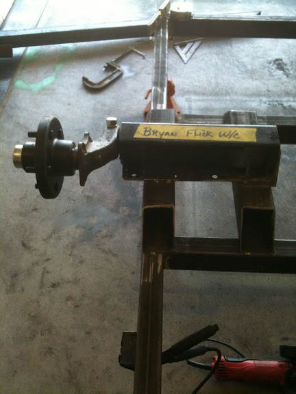

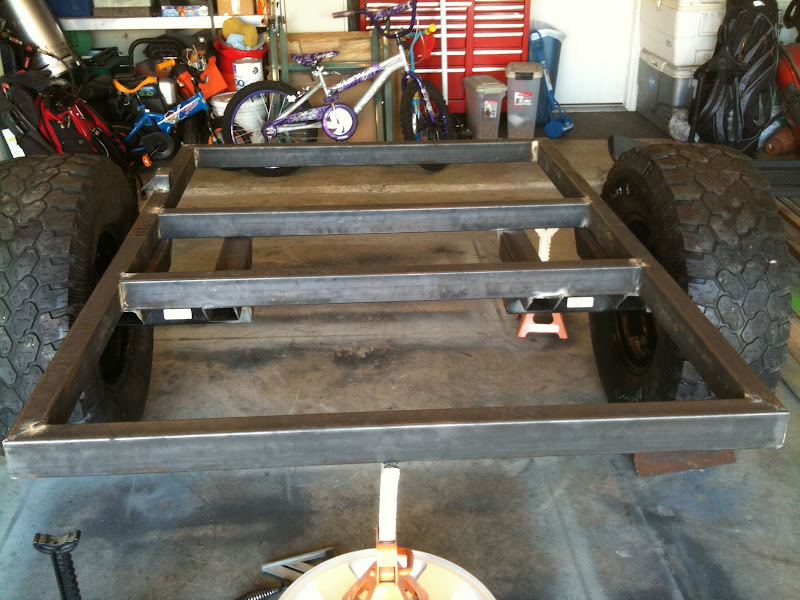

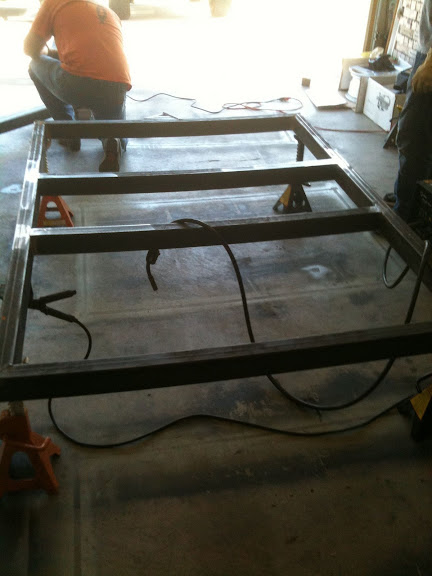

Squared up frame. Using 2x3 14ga
Axle setup (http://goo.gl/k32N) I went with these just to get the 5x5 bolt pattern that my Jeep has, not for the 3500 lbs.

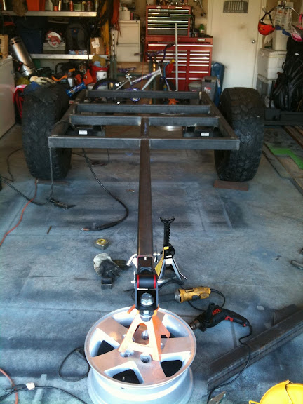

Mocked up with some 35x12.5" tires mounted

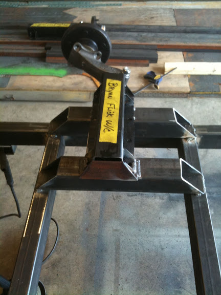

Front tongue started. Installed the receiver stock through the front part of the frame, and tied it to the front cross member.
Thanks to Martyn for the coupler. I could not be happier with it, and everyone that sees it just :drool: at the sight.

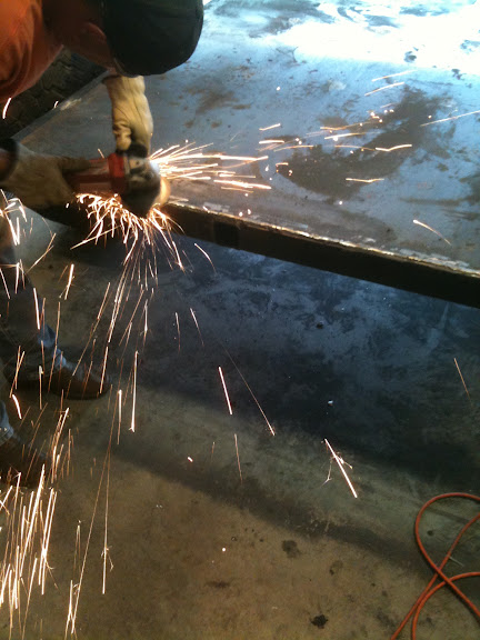

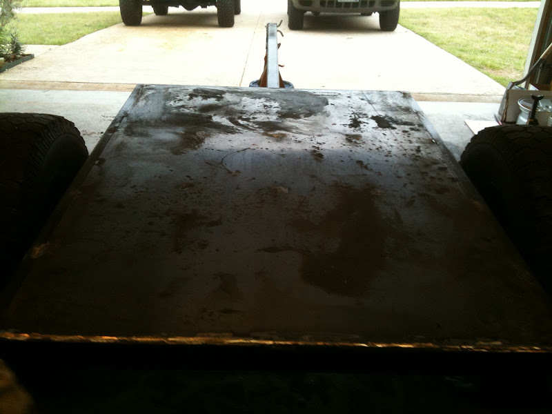

Bottom 14ga going on
I didn't get any pictures of it, but there is also some receiver stock going through the back of the frame and to the back cross member. It sticks out less than 1/4".

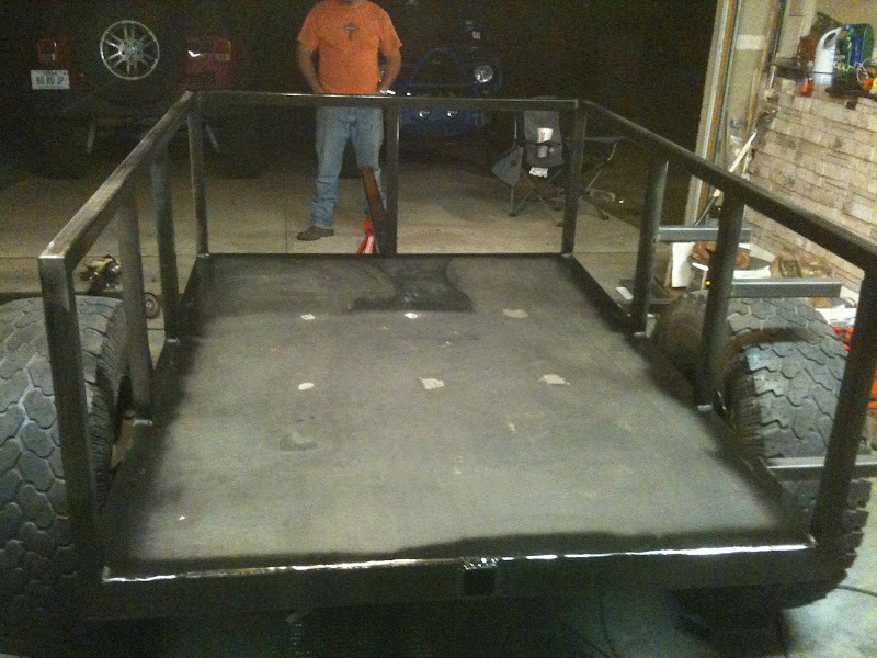

Floor done. It has 6 plug welds, 3 per cross member.

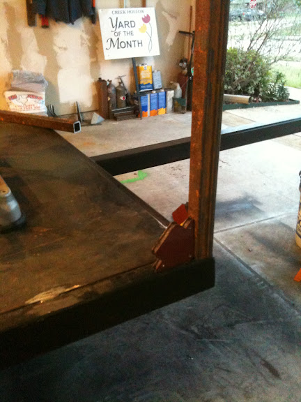

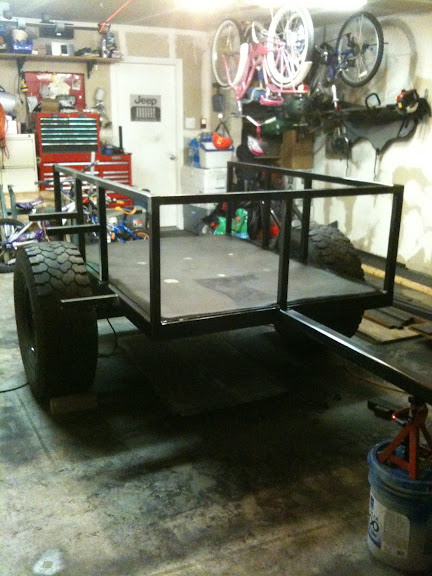

Checking height of wall. The posts are 20", so with the top put on it makes the wall 21.5" high.
Side rails up all around
Better view of the side rails, and you can really see the plug welds

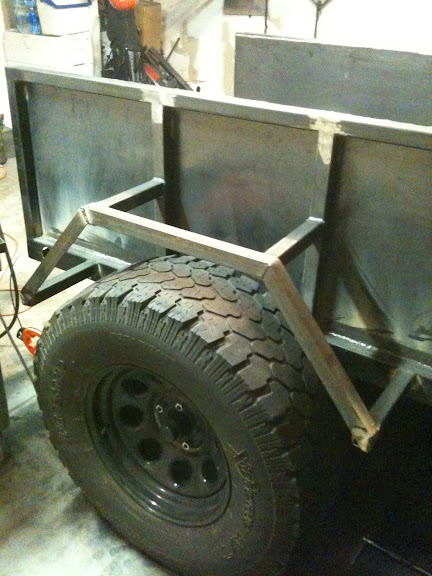

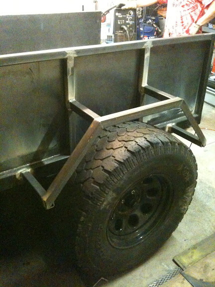

Fender support done

fish plates where the A frame ties to the tongue ?
What are "fish plates?"
The A frame is tied to the tongue with the same 2x3 stock that was used for the frame. We opened up the end of the 2x3 so it would go around the receiver stock, similar to how we opened up the frame to push the receiver stock through to the cross member.

"Fish Plate" example
Fish plate in magenta:
attachment.php
Normal is to use a strap of the same or less thickness as the wall thickness of the tube. Going thicker than the tube will cause problems down the road. Those mitered tips are not accidental. Try to avoid having weld beads that run perpendicularly across any tube or frame member. Can make them either solid like the rear half, or with rosette holes like the front half to increase the weld bead length.

flick
So TacoDell/ntsqd are you saying that I need fish plates on the front of the A frame? Or asking if I had done it?
What does everyone think of a tie down system, like the E-Track cargo control system, http://goo.gl/hyEr? Very similar to the other 2 I originally posted, except that I could weld it in.
ntsqd
Heretic Car Camper
With the diagonals essentially butted onto the front of the first cross member there isn't a lot of strength there because there isn't a lot of weld bead length. Adding the plates increases the weld bead length dramatically.
Also, at this point (the front of the first cross member) there is a large bending moment. I would consider adding straps to the bottoms of those joints as well. Adding them to the top won't do much good.
With a heavier trailer good practice is for the tongue diagonals to go under the front cross member and extend out to under the frame rails. This significantly strengthens the tongue to frame junction and adds increased rigidity to that area of large bending moment.

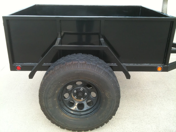

OK, so I have finally taken the time to get some more pics.

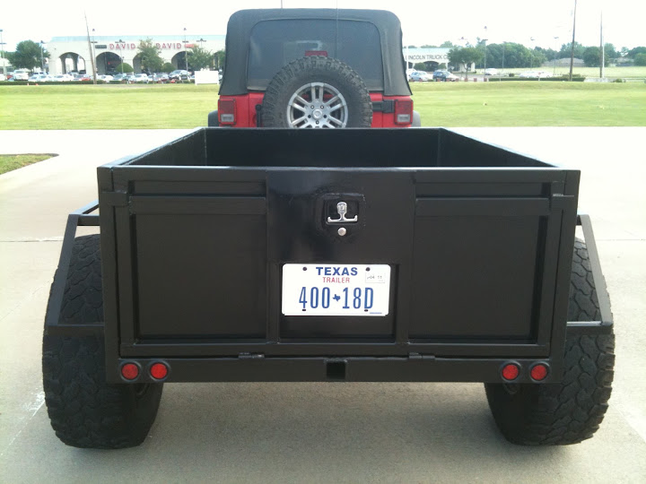

The trailer now has lights, a tailgate and a coat of black paint.
The lights, all the way around are the same, 2” Round LED Marker/Clearance Lights. I think they turned out great.

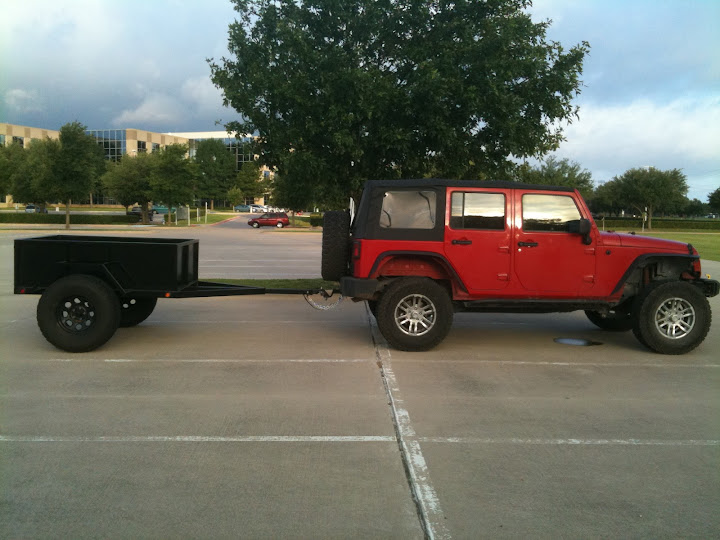

Sitting behind the Jeep. Going to get the trailer some new BFG AT KO tires, so (WylieJK) can have his tires and wheels back :D
Next up will be to finish out the fenders with some metal, a lid, and probably some expanded metal on the tongue. And after some thought, I think I will be going with the ETrack on the inside mounted horizontally about 1/2 way up the wall. Not sure, but all of this might wait until after my vacation.
