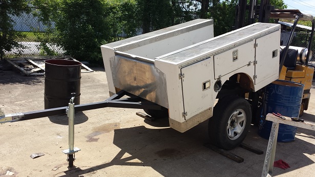

The trailer is assembled and it will go anywhere like it is now. But, my project was to finish some stuff that I have no time for now.

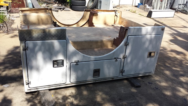

Made out of fiberglass is really good for this purpose since the weight is way less than any service bed made out of metal (I haven't got it to any scale though, but I could lift one side myself with effort of course). Also, the size is non concern since it is 65" wide being a little bit less than my Land Cruiser's 80 wide; kinda even though.

It is of fiberglass for mini trucks like Rangers, Tacoma, etc.

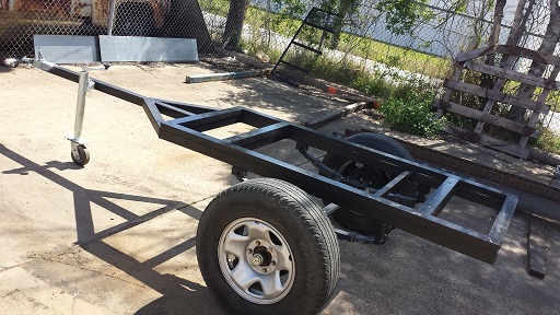

3500# axle with electric brakes built-in(not set up wires).
4 used Tacoma steel wheels and tires; 2 installed.
2 front CJ3 spring leaves (10)
Frame jack with wheel, & 2 stabilizers which need to be installed.
Frame made out of square pipe 2".
2" adjustable coupler.
Needs to:
Make brackets to put a RTT.
Attach brackets for shocks.
Fix turn, stop, back up lights.
Install Electric Brakes (you'll need brake controller).
