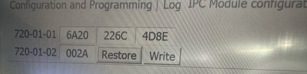

mwslaughter
Ok, so I entered the code as directed in the IPC Module 720-01-01 [6A20 3X22 6C4D] and Forscan gave me a warning message about checksum error. I clicked OK to just override the error, then I clicked "Write". Once it finished, the program altered the code to [6A20 226C 4D8E]. I really don't know what happened or why, but the end result is what I wanted and the error message is now gone so I am just going to leave it here.
If you try this at home, make sure to write down the default code so you can put it back together if it doesn't work for you the way it did for me.
