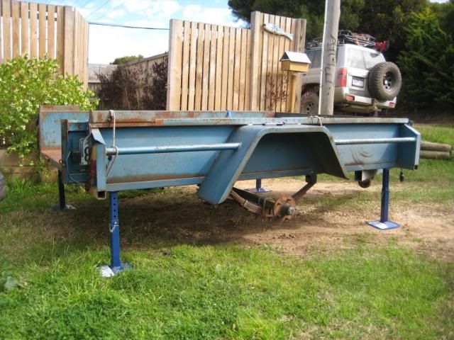

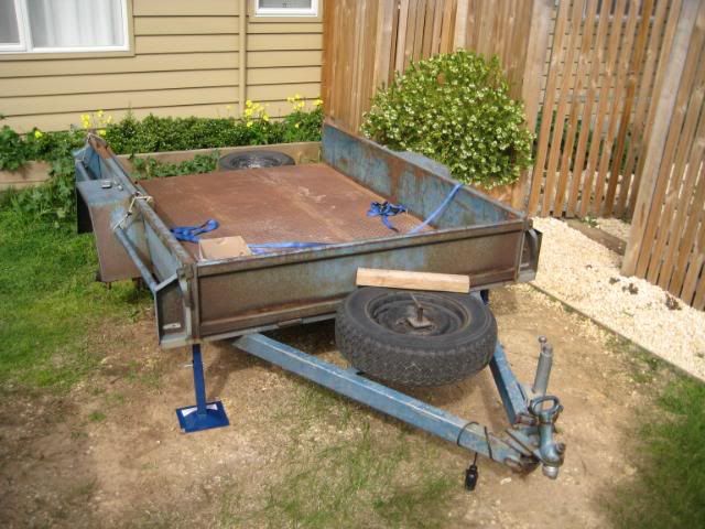

Scored this 5x7 trailer for the great price of... free!
the sides arnt very high but it'll be used mostly for a run around trailer. lugging fire wood, tail clean up days etc.. that will sit level with the patrol.
anyway first pics..

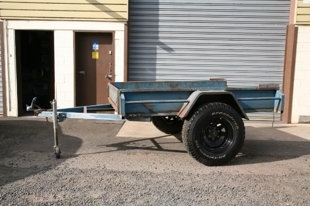

so keeping with the budget theme i scored these tyres and wheels..
tyres are BFG AT's 235/85 R16 .. the only problem is the offset.
Tyres scrub on the inner wheel arch, i dont want to buy wheel spacers.. to pricey!
i might need to get a longer axle but it seems a shame when the one on there is in good condition! Any sugestions?
4hilux

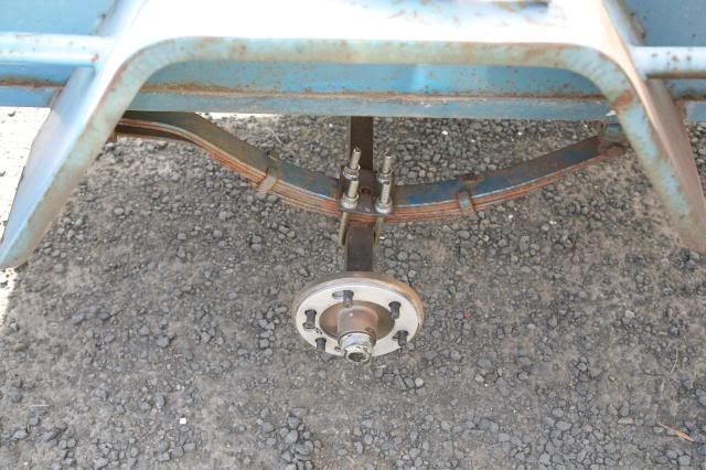

Hmmm, maybe its just me, but I'd love to know how you're getting those 6 stud Mitsi rims to go on what looks like a 5 stud hub.................?? Cool trailer though - as mentioned already, has heaps of 'potential'. I'd be mounting springs on top of axle too, something I've done to mine. Not a big job to do, honest. :) ;)
Edit: Sorry, I see you have SOA on jobs to do...........
miller_au
4hilux said:
Hmmm, maybe its just me, but I'd love to know how you're getting those 6 stud Mitsi rims to go on what looks like a 5 stud hub.................?? :) ;)
lucky im not an idiot and have replaced the 5 stud hubs with 6 stud hey!:rolleyes:
4hilux
Well mate, given the photos ya had up - I just had to ask.........:)
The rims you have look like IFS offset. Refit yr tyres to some std 16 inch rims off a 1990's beam axle Hilux or Cruiser - that'll fix the rear clearance problem.........;)
miller_au
yeah i know.. thanks for the concern..
yeah they are ifs wheels, been on the hunt for some cruzer wheels but the ones ive found are a bit exy

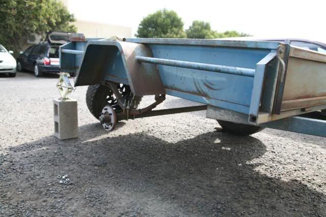

Bit of an update...
Completed the spring over and replaced the 5 stud hubs with 6 studs
removed the old tail gate as it was rusted out and puchased a new one..
I got some cheap wheel spacers (the disc type) but then I scored 2 new 80 series offset rims for $50! they are 16x7" so i could keep the 235/85's. So thats wheel problem fixed!

yeah yeah i know i shouldnt have the jack on a brick

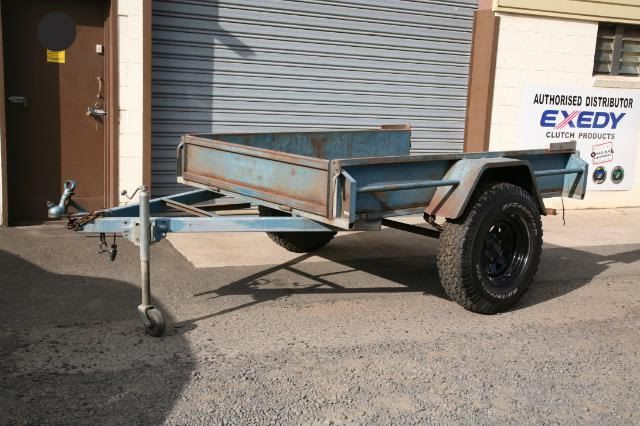

now it sits a little higher than level with the patrol
