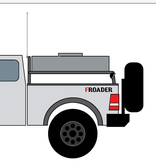

I made up a rough idea in photoshop of what I want it to look like.
Hopefully, I'll be able to start the transformation soon.

Yeah, I want a drawer system for mine as well. With the roll-up tonneau that I want to get, I'll be able to do that and still be able to put things in there with it open.

You'll like the combination of a bed rack and roll-up cover. Mine has worked out well over the last couple of years. The rack holds our aluminum equipment boxes, and the bed holds everything that needs to stay dry. It's easy to organize and gives us room for gear for four. Mine bolts into the stakepockets, so the truck can pull DD truck duties without the rack in place.
FROADER
Very nice.
Thanks, Jim.
You said it exactly right in your thread:
It had to be high enough to allow the cover to roll up, but be low enough so gear wasn't standing taller than the roofline of the cab.
This is what I'll be aiming for with the RTT installed, so we'll see how tall I can actually make it. I also plan on making it easy to remove to still be able to carry taller items.

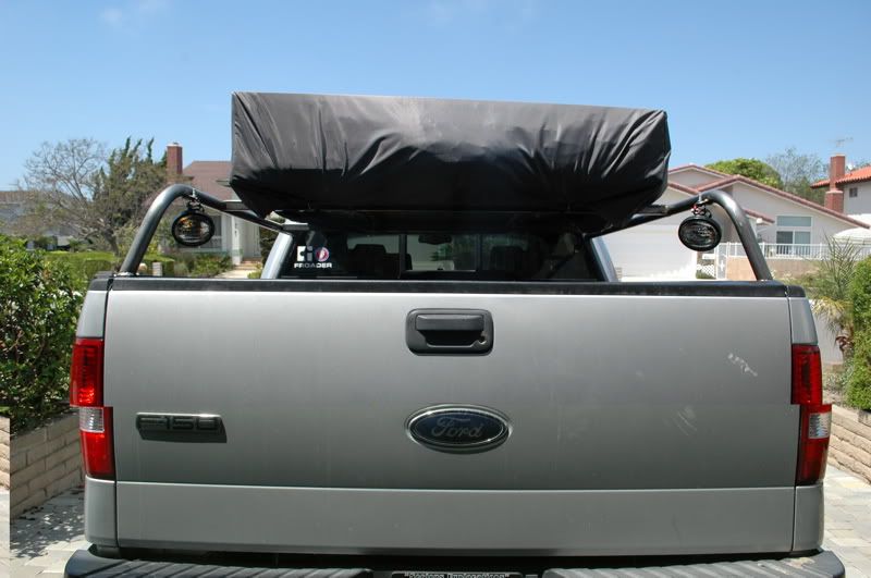

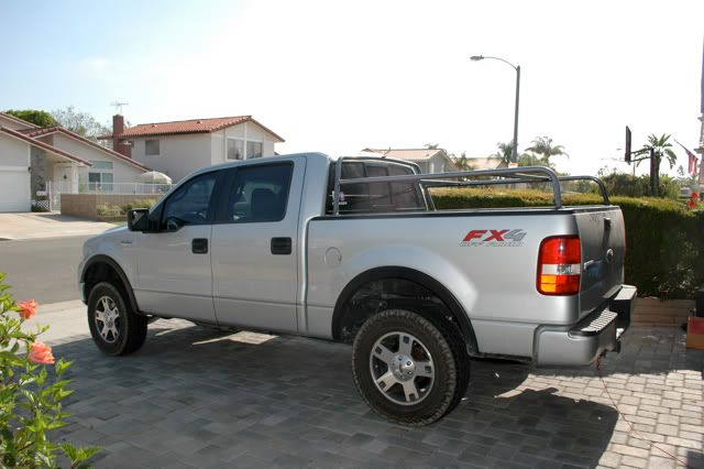

Finally an update!
I recently purchased an RTT from a member here and had a chance to build my bed rack to mount it yesterday.
Here was my plan.
It doesn't suck having a best friend that has good fab skills with all the right tools who likes to use them.
Winter and I decided to get started last night so we weren't working during the hottest time of the day today... We planned to get everything bent and mocked up, so today would just be burning all of the welds in. We started after 5 pm and ended up "finishing" it after he burned the last weld just before 1:30 am. So we don't have to work on it at all today! :)
Material:
Front and side hoops - 1.5 1/8 wall
Square cross bars - 1.25 3/16 wall
Angle iron - 1.5 3/16 wall
Here are the pics from last night.
Fab:
FROADER
Update (cont...)
Welds:
Just like my drawing, it's got a tab for the antenna at the top of the hoop in the middle and two tabs for lights near the rear of the side hoops.
I'll be getting pics of it in the light today with the tent on top/deployed too. Then it will make it's way to the powder coater (hopefully sometime this week) and be done! I decided against the hi-lift mounts on the side hoops for mounting it on the rear bumper (when that gets built).
This cost me less than half of the Thule Bed Rack and it looks much cooler. :)
