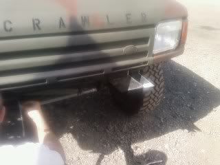

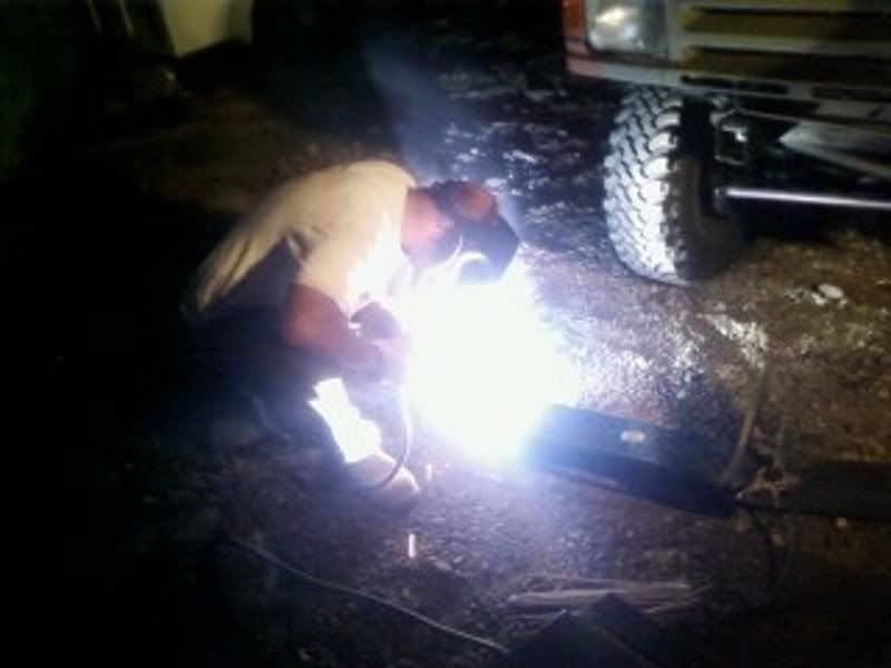

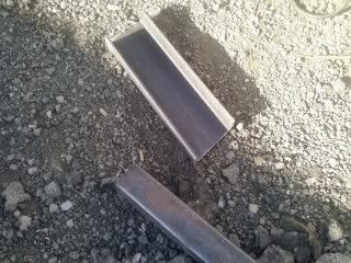

well the time has come for me to start my front bumper buildup. My friend is building this bumper for me. It has a 1/4 thick steel winch plate with the 3/16 channel steel that will be welded in with a 3/16 plate making it completely boxed also the fender protection is welded to the 3/16 channel steel. The fender protection is made of 2x3 1/4 thickness rectangle tubing.
The mounting brackets are 12 guage steel and will be completely boxed as well using grade 8 bolts.
heres a few pictures of the start up.

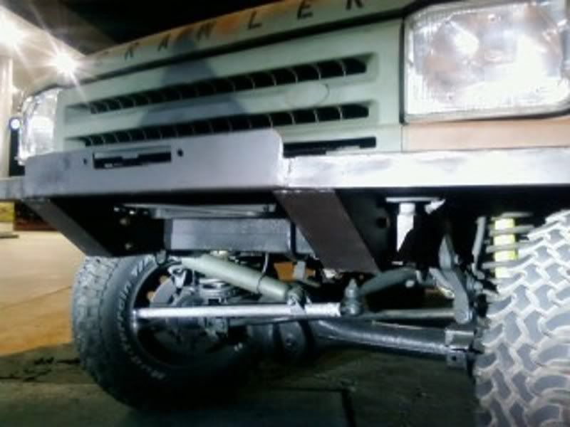

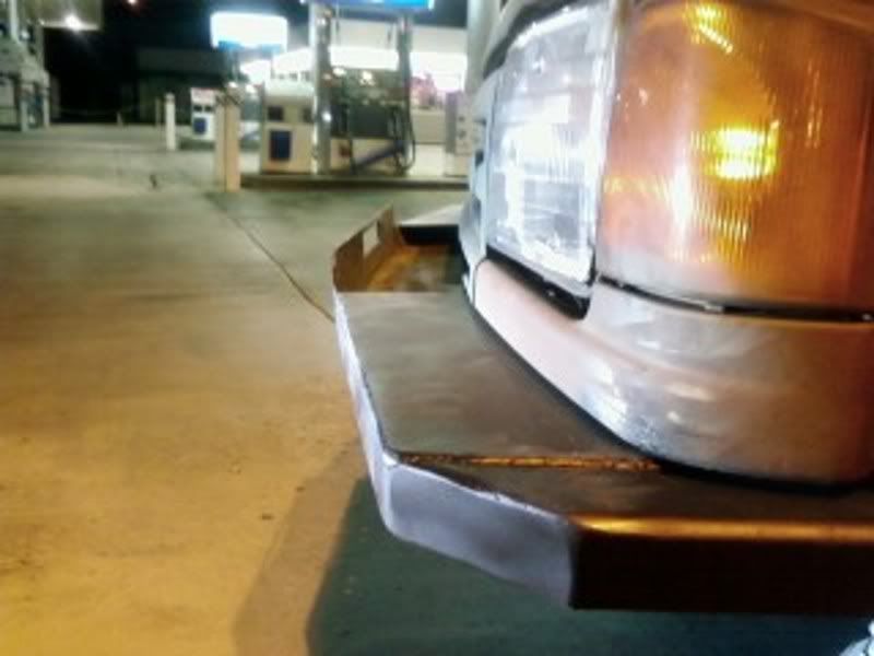

bumper is 90% completed.
this coming sunday my friend and I will be welding on a A-bar similar to a RTE but with my own taste.:punk03:
heres some pictures
