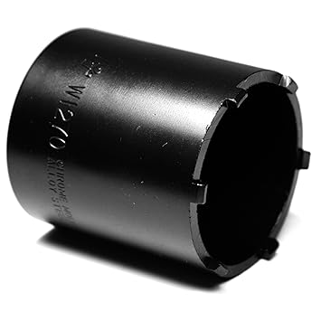

Wilmar W1270 Ford/Gm 4 Wheel Drive Lock Nut Tool (modified to fit)

nwoods
What is this for:
And why do you have to modify it?
