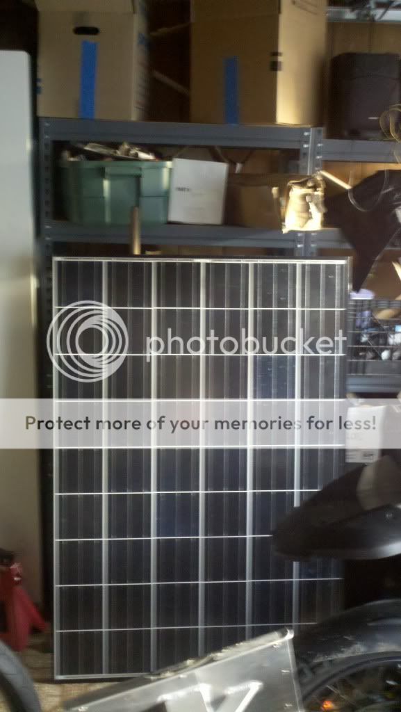

Bought this Solar panel from a sub-contractor on a project 2 years ago. Original plans were to mount on my Sportsmobile. That never happened and its too big for my 100 series or current trailer. It has never seen the sun other than loading and unloading into my garage.
This is no radio shack/harbor freight panel. This is the real deal.
Retail they are around $1000 asking $500.
This is just the panel I do not have a controller to go with it. The body is all aluminum.
Specifications
Electrical Performance under Standard Test Conditions (*STC)
Maximum Power (Pmax) 200W (+10%/-5%)
Maximum Power Voltage (Vmpp) 26,3V
Maximum Power Current (Impp) 7,61A
Open Circuit Voltage (Voc) 32,9V
Short Circuit Current (Isc) 8,21A
*STC : Irradiance 1000W/m2, AM1.5 spectrum, module temperture 25°C
Electrical Performance at 800W/m2, NOCT, AM1.5
Maximum Power (Pmax) 142W
Maximum Power Voltage (Vmpp) 23,2V
Maximum Power Current (Impp) 6,13A
Open Circuit Voltage (Voc) 29,9V
Short Circuit Current (Isc) 6,62A
NOCT (Nominal Operating Cell Temperature) : 47°C
Module Characteristics
Length (mm) / (inch) 1425 / 56,2
Width (mm) / (inch) 990 / 39.0
Depth (mm) / (inch) 36 / 1.4
Weight (kg) / (lbs) 18,5 / 40.7
Cable (mm) / (inch) (+)720/28.3 / (–)710/70.9
Junction Box (mm) / (inch) 113.6 / 4.5 x 76 / 3.0 x 9 / 0.4
IP Code IP65
Reduction of Efficiency under Low Irradiance
Reduction 7.8%
Reduction of efficiency from an irrandiance of 1000W/m2 to 200W/m2 (module temperature 25°C)
Cells
Number per Module 54
