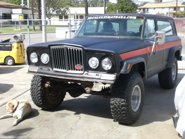

I needed something that I could turn into an expo rig that wasnt going to break the bank, that had plenty of grunt, something I could find parts for anywhere easily, and of coarse reliable. I had this ole 1974 Jeep FSJ for awhile now but there were some issues with it. It had an old tired 258 six cylinder engine hooked up to a worn out 3 speed and the spring were soft. Well for that matter It out lived its usefulness to me. On top of all that the parts countermen didnt have a clue as to where to obtain the correct parts for the beast.

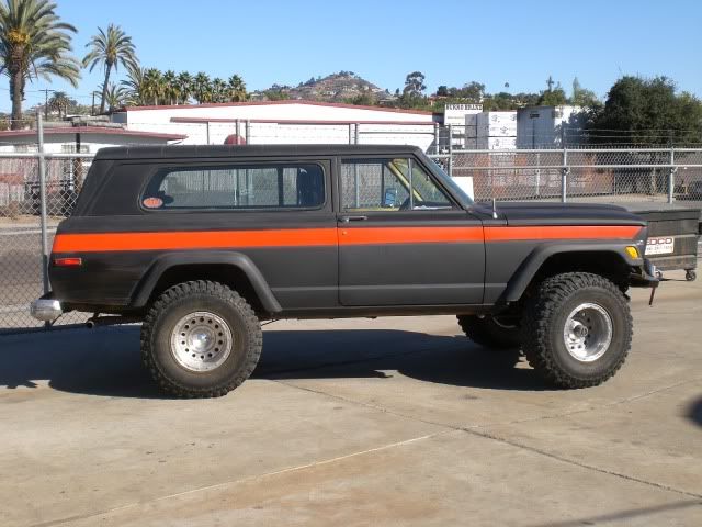

The answer in my mind was to put the body on something more functional and modern. I found a good running 1977GMC Jimmy that mechanically was very sound. The body was shot after years of neglect. So long story very short, I attached the FSJ body to the frame and running gear of the GM Jimmy / Blazer. Im just now finishing the final hook ups like bumpers, exhaust, and wiring but it looks like its going to be perfect for what I want... an Expedition / Advdnture rig. Now I need to get busy on the fun stuff. lol :wings:
A before and after shot...
So what I gained by doing the swap was a 350 V8, Automatic, Wide track axles, about the same as a 10" lift, Great suspension on a very stout frame. I think it will be a great foundation for the Expedition rig I want.

Of course you had to go GM to find another vehicle with more rust than one of our beasties! Haha..
Can't really tell from the pics but did you keep the rockers? That much lift shouldn't be an issue but you will want to protect them if they are in good shape. And drill some extra drain holes in them so you can rinse them out from time to time.
Are those Chief badges where the pie plates should be? Heehee...nice idea! And there really is nothing more manly looking than the Glad grille! Of course I'm a little biased...

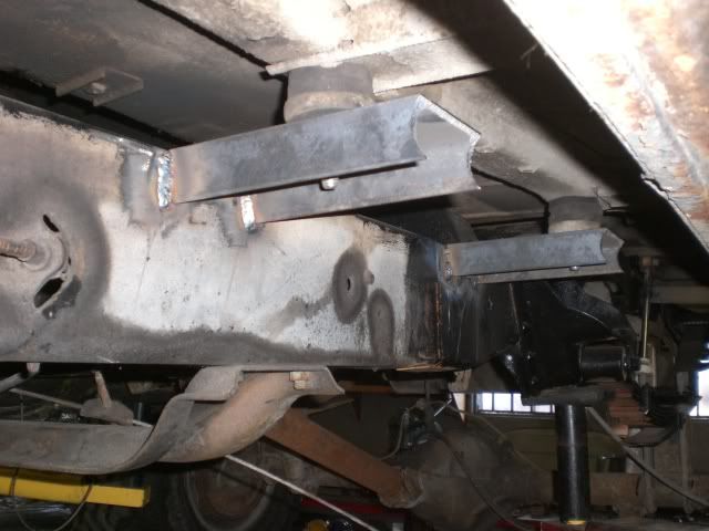

Ya know the rockers are in great shape. But Im going to shave them off and use sliders in their place. I built my body mounts to accept a 2" tube that will run the length of the frame under the body. The sliders will tie into that tube as well as the cage when I perf. the floor.
heres a before shot
The new body mounts...

Ya know the rockers are in great shape. But Im going to shave them off and use sliders in their place. I built my body mounts to accept a tube that run 2" tube the length of the frame under the body. The sliders will tie into that tube as well as the cage when I perf. the floor.
heres a before shot

All I had to do was extend the frame length 2.5" to bring the wheel base to the original FSJ 109" and a strech on the rear drive shaft. The Steering column fit perfect with no adjustments at all.
Best part is its still a California pre smog vehicle!
