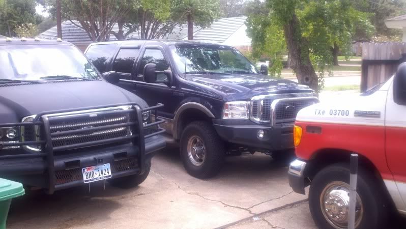

Here is my Ranch Hand Bull Nose. It's sturdy but not as heavy as you would think. I've also got a couple Hella offroads lights too.
Sorry for the bad photo. When I get some time I'll take some photos with my good camera.
