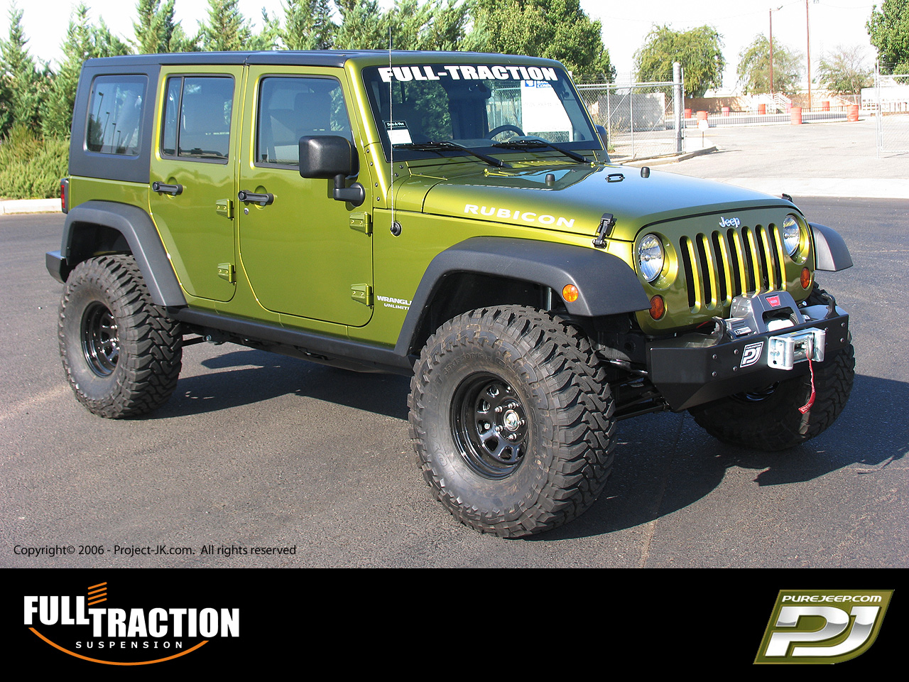

Full Traction gets ahold of a 2007

I'd be sold on Full Tractions stuff if they would stop using the damn heim joints. Their ability to retain a true 4 link up front with long arms is damn impressive (FYI, RE, RK, et.al. use a radius arm setup and call it a 4 link). I haven't heard too many complaints about the FT heim joints failing, but I like the cartridge joints that I can adjust when needed, and eventually take apart and rebuild. There is also ALOT more surface area with the cartridge joints, so the shock loads are spread out over an area 2 - 3 times as large as the heim joints, which one would assume leads to longer life (although I have no scientific data to back that up).

I like, but I don't like the wide tires that stick out. I hope the JK is slightly more forgiving than the TJ in terms of wheel well depth.

Oh BTW I finally see pics of a Jeep I would buy!!! :wings:
